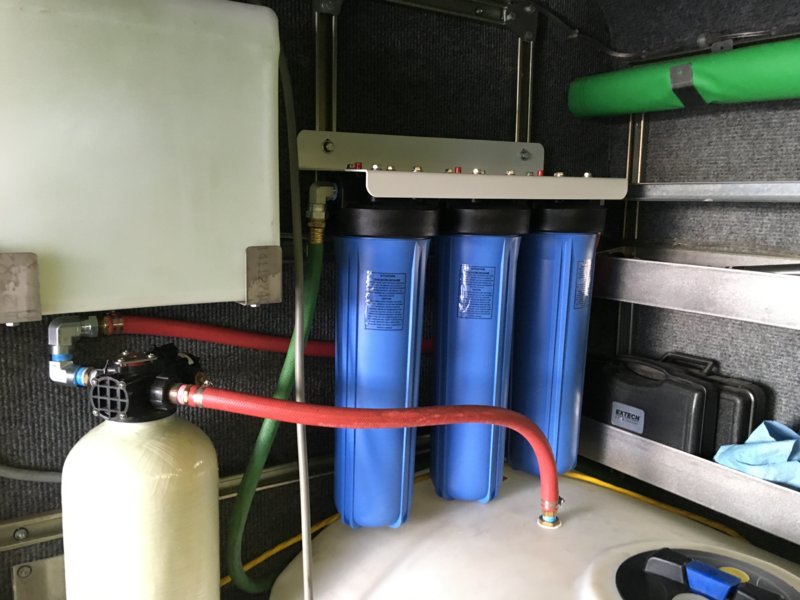

Been running this softner for 9 years. I just put new resin in it. Now I run a chlorine, carbon and fine sediment filter. I should never have to replace the resin now that I'm filtering chlorine. During my busy months I regenerate about 1x month. So easy, 3 min to hook up and the timer turns off when done.
