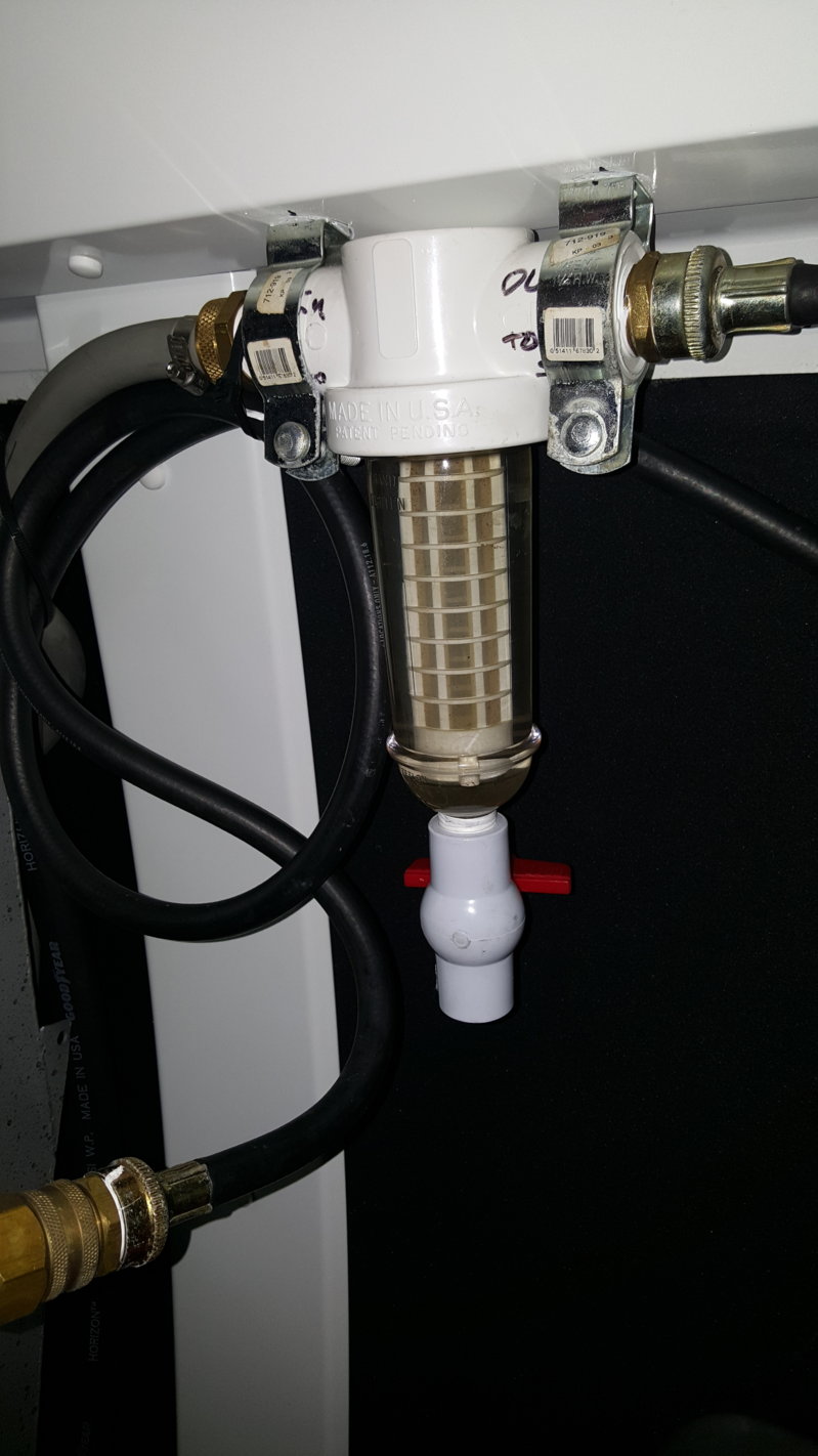

Here is a pic of one we are using in our vans currently....
I cannot remember the mess size but works great for us.....
