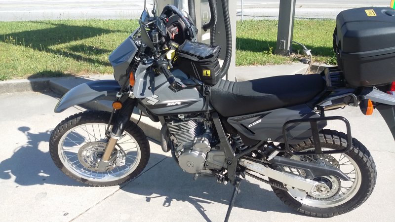

Fred I see why you wanted to take the 4 hour ride.
I am at exit 350 on I75. Graduation weekend or wood of bought a cheer wine for ya halfway home.
Nice bike and great weather in our part of the world.
