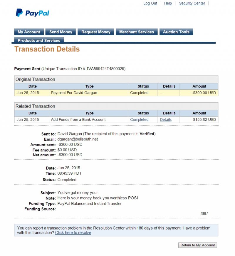

I don't know what to say David except here is your money back you useless POS.
