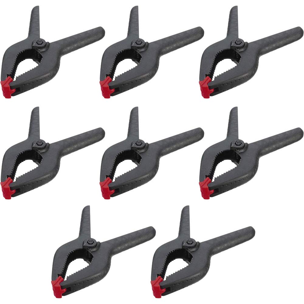

Perf Pipe would work better for your drying beams whites too slippery.
Or use big plastic spring clamps.
Brian that does work, you could also use a tac-it gun .
The other reason we use perfpipe is the"perf" allows some airflow whereas the white doesn't.
There are also slight dimples which help grip the Rug.
But you can also "diaper" the corners with the clamps which is handy.

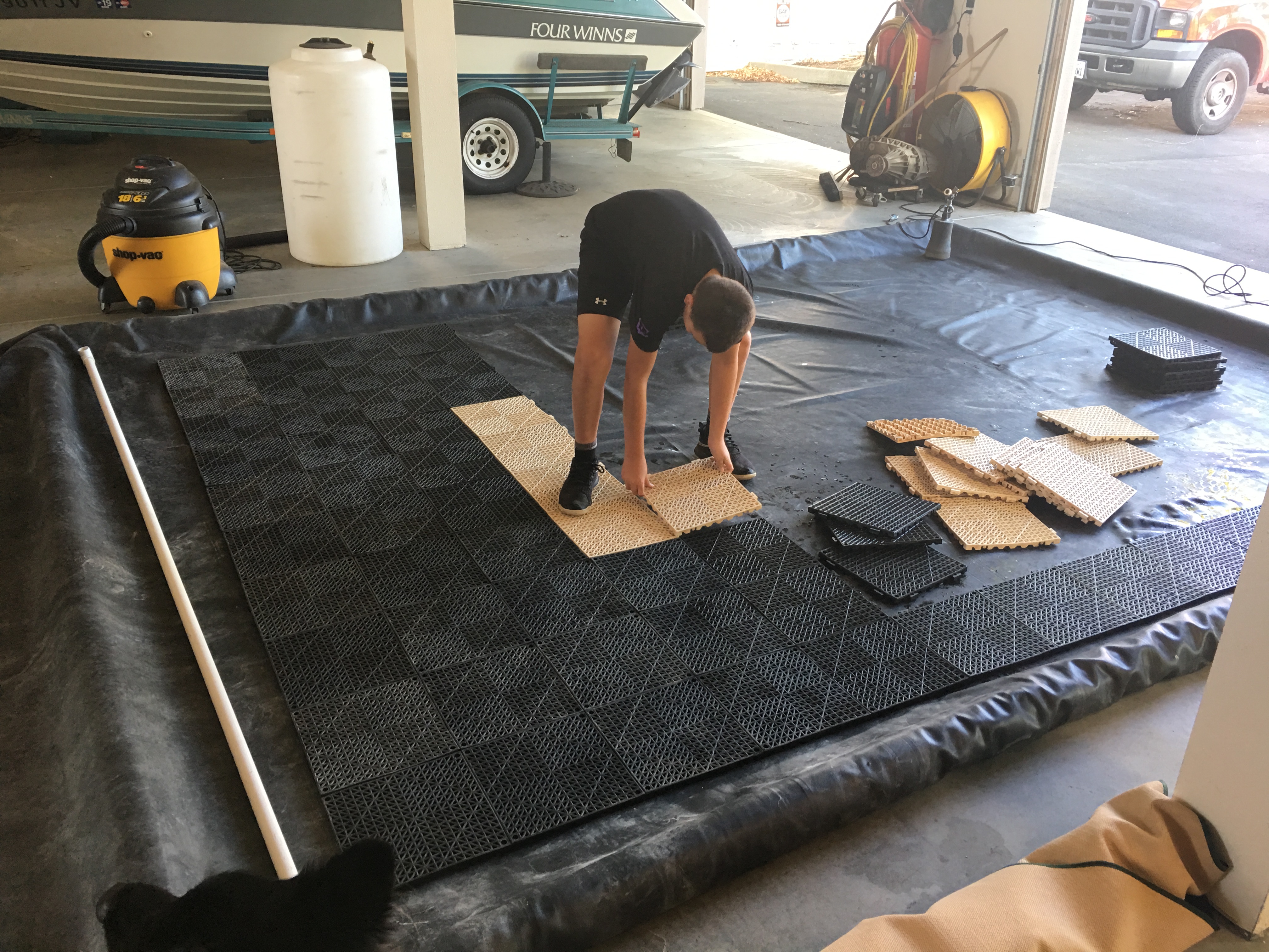

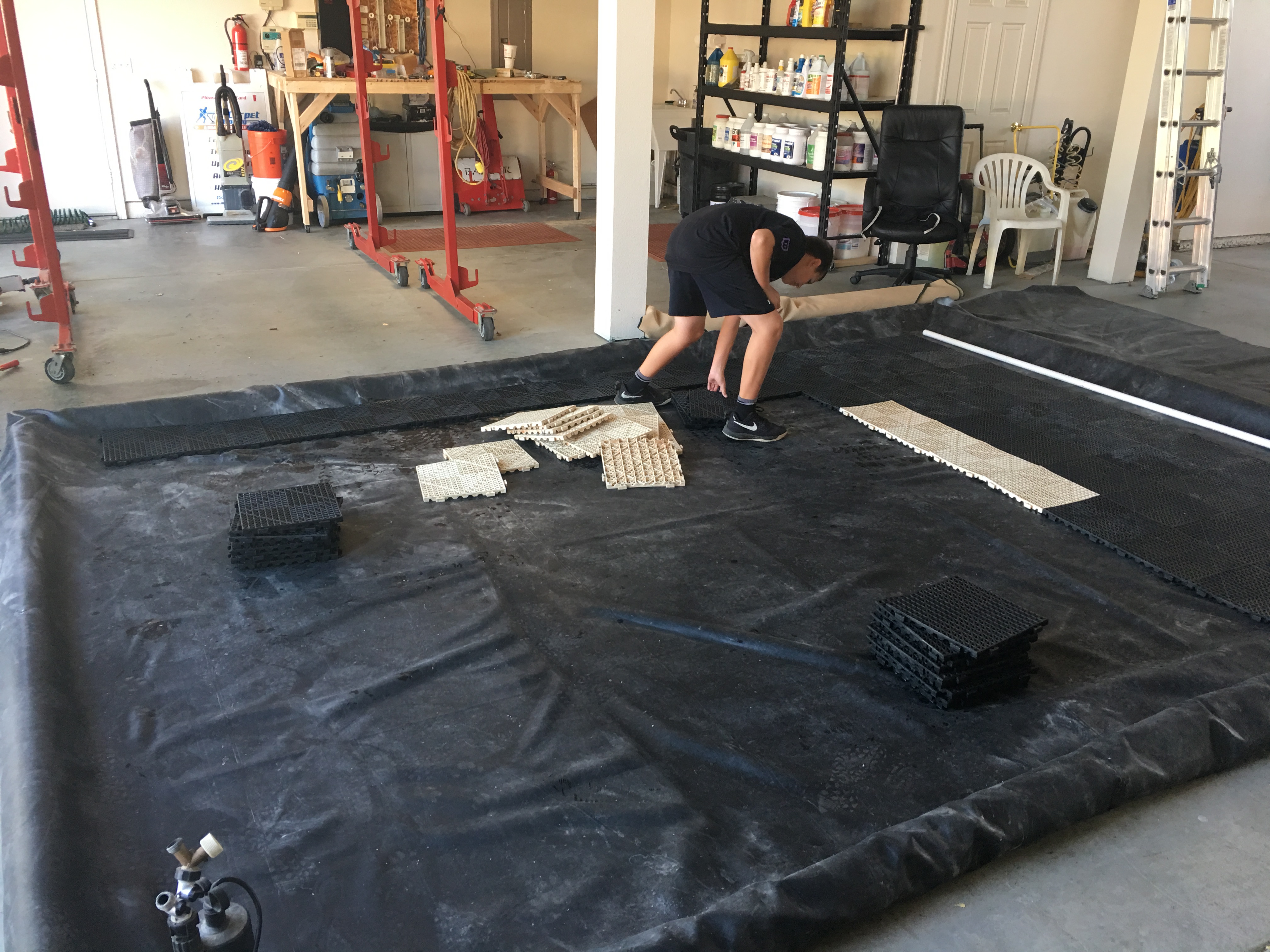

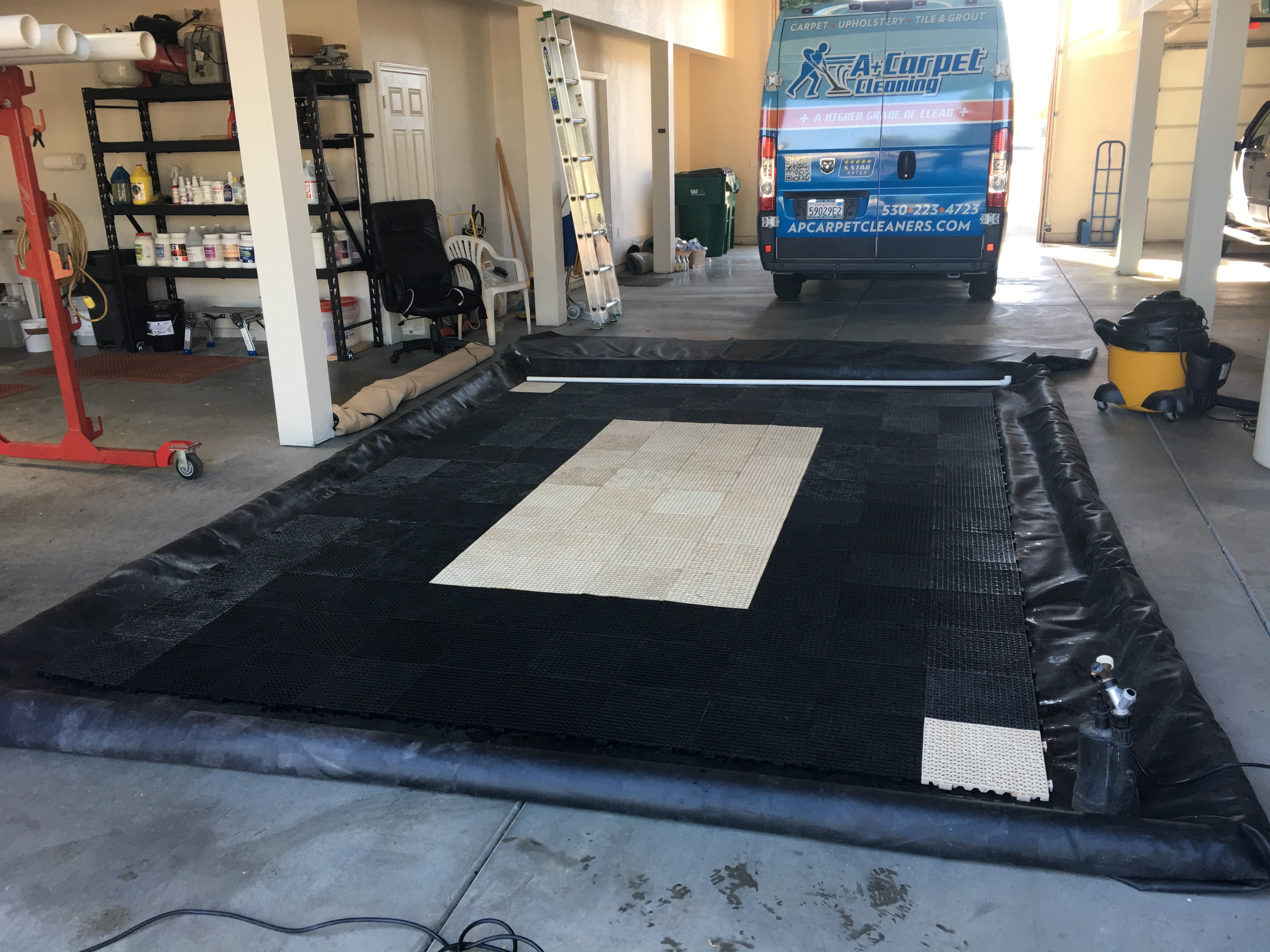

I'm still working on my Rug Pit. I was going to work on it a bit more today, but i'm just too tired. Macy and I had two large jobs today. I told her to take the rest of the day off. But I need to put my tiles together. They all need to be pressure washed. I'll probably do it this Saturday. I have a urine soaked rug in my shop waiting to be cleaned. It has a latex backing, so they are screwed. I'm still going to soak it in Uturn and flush the urine out the best I can.

Did you have a lawyer pen up the disclaimer?
No, but I was pretty blunt. I told them there is a chance the latex could let go and that the urine stains on the backing will probably always be there.

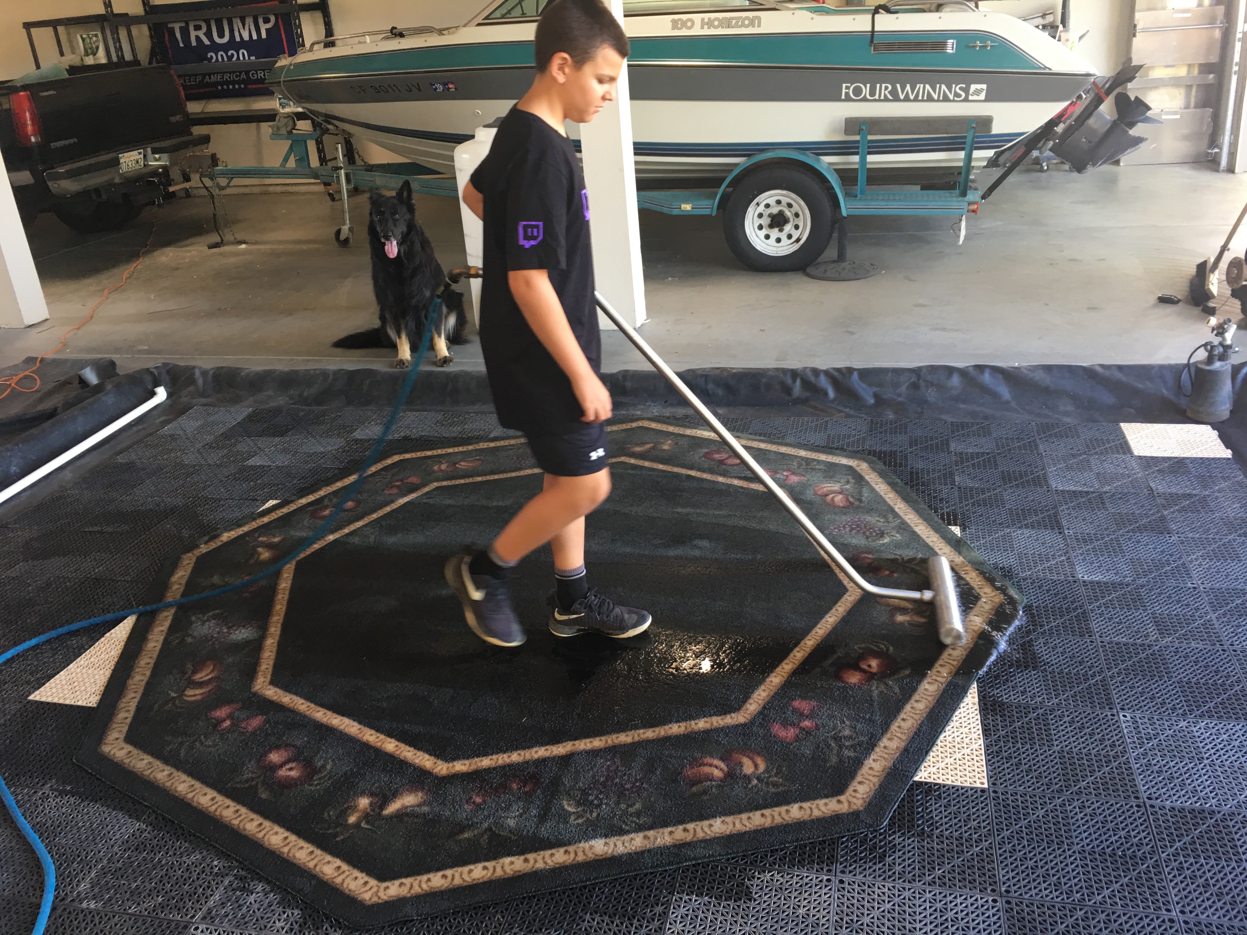

I've never even seen a rug squeegee let alone used... are they much improvement over using a wand?
24,126
That "Squeegee" thing is a flushing wand. It's connected to a garden hose. helps to flush out all the soap and urine. I think it is an improvement. seems to float across smoother than a wand.
my bad, I meant flushing wand.
I'm thinking of putting hose fitting on my evo wand instead of sliding hose down the tube, my evo is a backup that hardly gets used but it slides well
