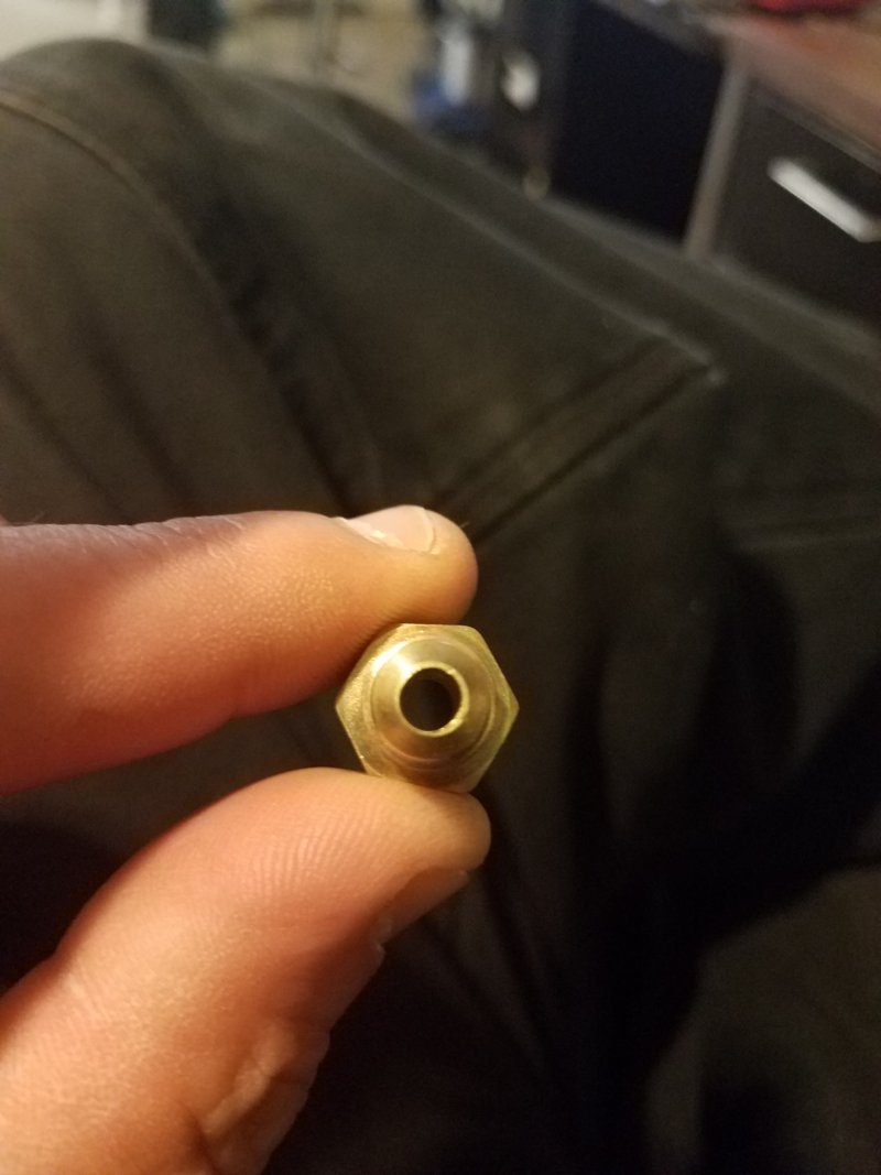

You are the expert Keith but in my case with the Blazer, there is a bypass to the waste tank from the water box temperature relief valve. It is vacuum operated. If there is a leak in the fitting or hose, I will be losing some vacuum. I also have a temperature bypass needle valve that is connected to the waste tank. Same thing, if the fitting or hose is leaking, I am losing vacuum. When I look at pics of the Apex, on the right hand side facing the machine, there are a couple of hoses that look like they are attached to the vac system somehow. Maybe I am wrong, I can't see the whole picture. I am just thinking if this machine froze, there can be a lot of small cracks causing a vac leak.

Nope you are wrong.. If it is sucking water it is still a sealed system, no air!! How much could you lose through this little hole anyway?

If it is cracked, then it is no longer sealed. You are sucking air and water and you're right, it is just a little hole but if you have lots of little holes?
27,162
Go look at a Blazer and you will see what I mean. If the Apex is different you are right. BUT IF THE FITTINGS ARE CRACKED ON THE BLAZER, IT'S SUCKING AIR! Maybe not a lot but enough to prevent getting a good seal. The fittings go right through the waste tank.

Where the fittings are connected to the waste tank. They are just ordinary brass fittings prone to cracking if they freeze. Judging by the condition of the water box, the previous owner may have left the machine full of water. If those fittings cracked where they are inserted into the waste tank they may have a larger hole than just the fitting itself. Sorry for yelling.

I gotcha.. Those compression fittings fail alot when they are old.. There isn't anything on that end that would effect vacuum..
