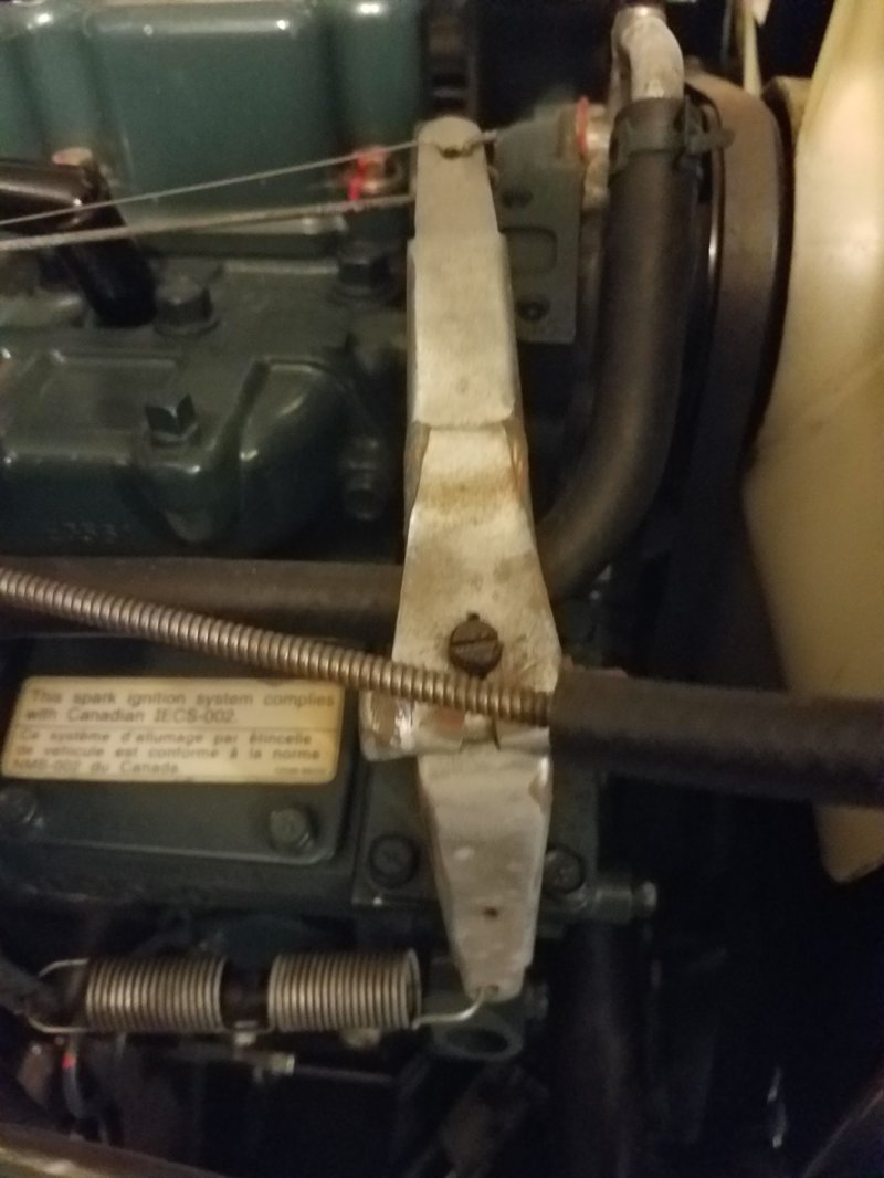

Does the governor move when you put it under load? Seems to be running good and doesn't bog down.. How many hours are on it?
Haven't checked the governor. The hour meter read 851 when I bought it a month ago. I expected this machine to be in "like new" condition. Very disappointed.

The RPM'S are probably low, so that should be adjusted.. Governor should be fine, easy test though.. Put a load on, and look at this to make sure it's moving..

So, I got to thinking about that governor and the vac relief valve and the RPMs and thought, "I'll manually ramp up the RPMs using the governor and see what happens." Started the machine, set throttle to full, blocked off the vac ports and pushed the governor to full open. The vac relief valve barely started to crack open. But, the Hg DID go up to 14.

Make sure the governor isn't sloppy..
Does it move under load?

Yes the governor is adjusting properly.
