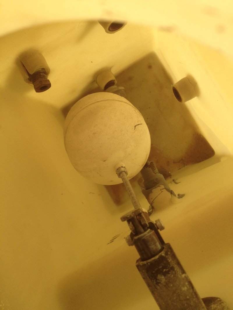

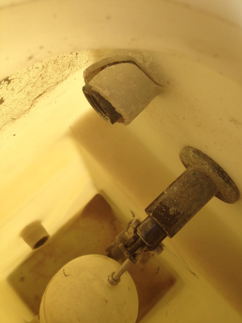

I just bought this machine used with a van included. I didn't expect to have issues right off but I did. And now I find out that a new water box will cost $450. After all the other costs I've had to put into this rig just to get it up to workable order, I'm just tapped out. Someone tried to repair this water box in the past with epoxy. It didn't work. It leaks and floods the van every time I use it. And it is cracked in many other places - just waiting to burst and make the unit unusable. Disappointing to say the least, but I have no choice but to try and find a way to make this work.

Makes me wonder if it froze full of water. You want to make sure your heat exchangers aren't leaking as well.

I agree with you. Once I got the old one out where I could look it over closer, it seems obvious to me that it froze. All the ports were cracked or broken.
28,273
Wow, that some serious damage. I hope the rest of your machine is ok. When you hook up the water box, run the machine and check for leaks. Bring it up to full temperature and run for a while simulating carpet cleaning or actually cleaning some carpets. Pay careful attention around the heat exchangers. If you have any water running in the van, take a flashlight and check where it is coming from. It is normal to have small leaks at fittings that are loose or need O-rings but check your brass for cracks.
