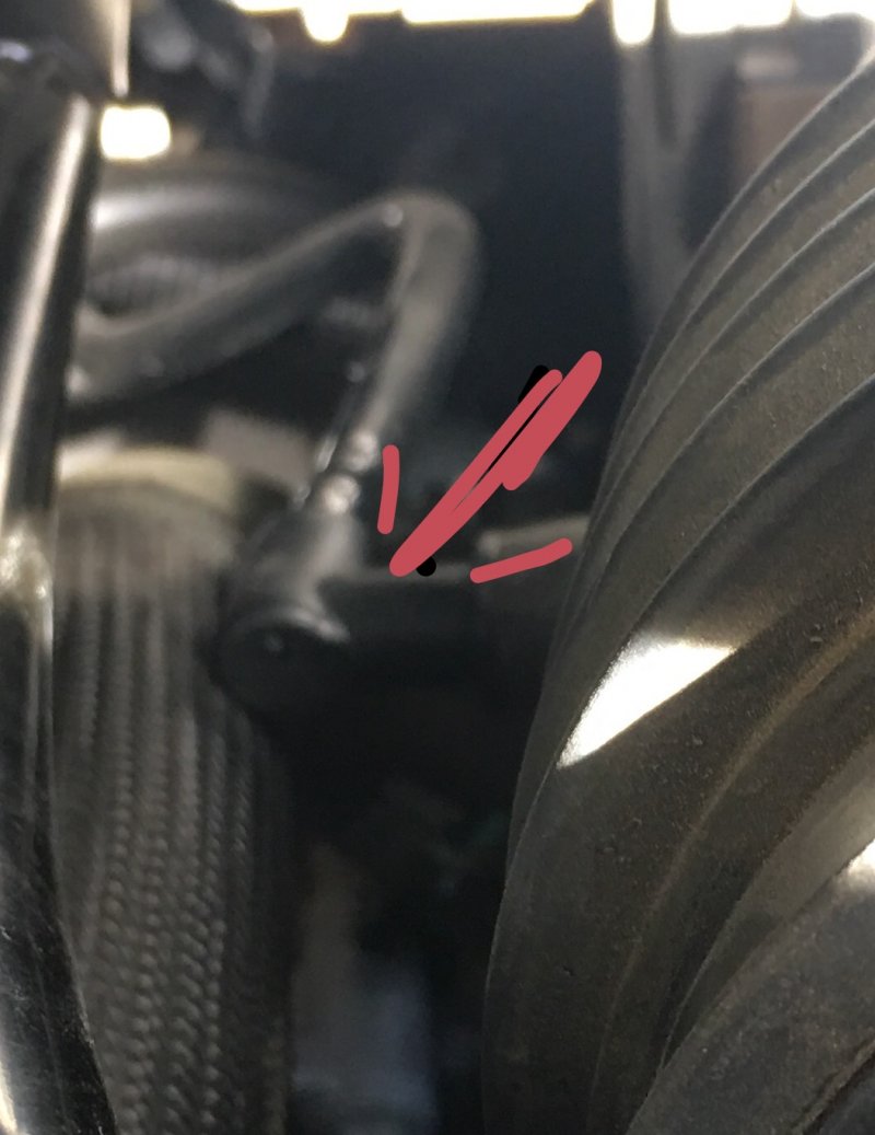

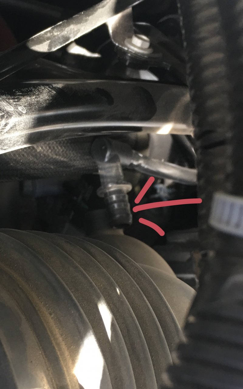

looks like a vent tube or a vacuum line. If its a vacuum line, it can mess everything up while it's off. Very simple fix but annoying to figure out if you don't know it's the issue.
11,137
Ok so the light was on when I found the vacuum tube off,
Stayed on until the next morning as I went to a huge job, van ran for 5 hours and the light stayed off.
Gotta guess when the guy who put in a new serpinetine belt that was precautionary warranty work for free by sapphire he pulled all the air stuff off to get at the belt.
He probably just didn't reattach that one.
Here's praying that's all it is on my new van.
