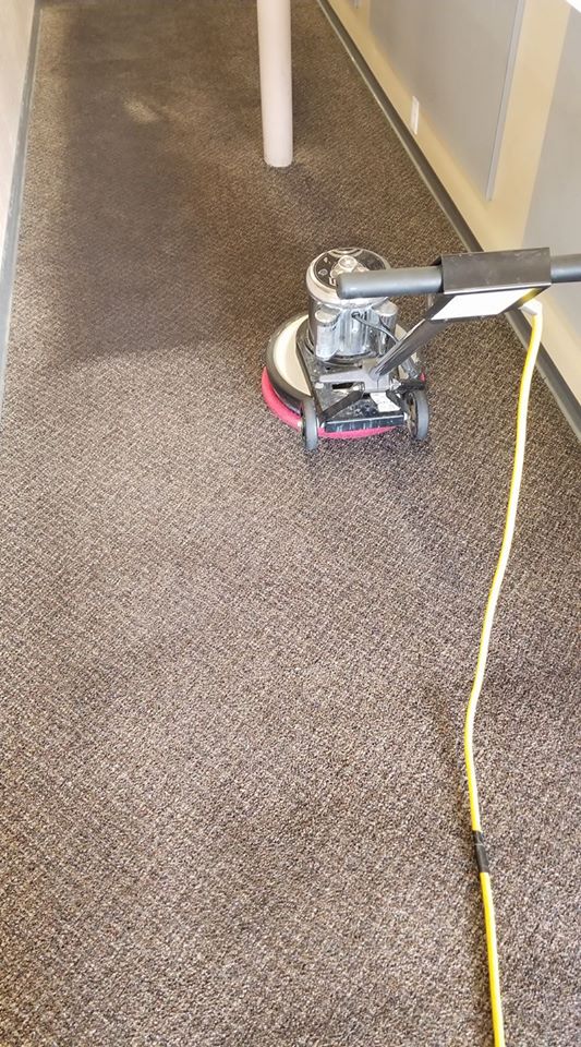

Keep in mind I've only used these two chems ONCE...
But once is enough to form a few opinions when cleaning carpet this dirty, especially when I'm the only one who's ever touched it.
It's been cleaned 5 times since April of 2016
I've used the Cimex to pre scrub and usually use 360i to flush it well. All of which takes too much time and since the owner wont clean it as often as it needs, I'm at the The Hell With It point.
Extra strong prespray, 175 scrub, strong Alkaline rinse and 3 dry passes is what I did last week. And while quicker, I learned that I need to use MORE pres spray and a fresh Red pad to get it down deep. Too many areas needed a full second treatment
So today I used Olson's Prochem Duo.
and POW!
Best grease pit prespray I've used to date, based on this one job......
NO boosting, NO adding more than what the label says, which is 2 ounces per gallon.
Everything released real easy and almost no post spotting needed. Butyl stench was at a minimum.
I doubled up on the rinse which the label says to do on extreme soil, and being a rinse it just did its job with no fanfare other than stinking the van up on the drive home. PeeeU.
At a 1/2 gallon per 5 gallon jug :eekk:, I think I'll use Flex Ice next time.
pre cleaning..
pre sprayed and Red padded only
rinsed...
