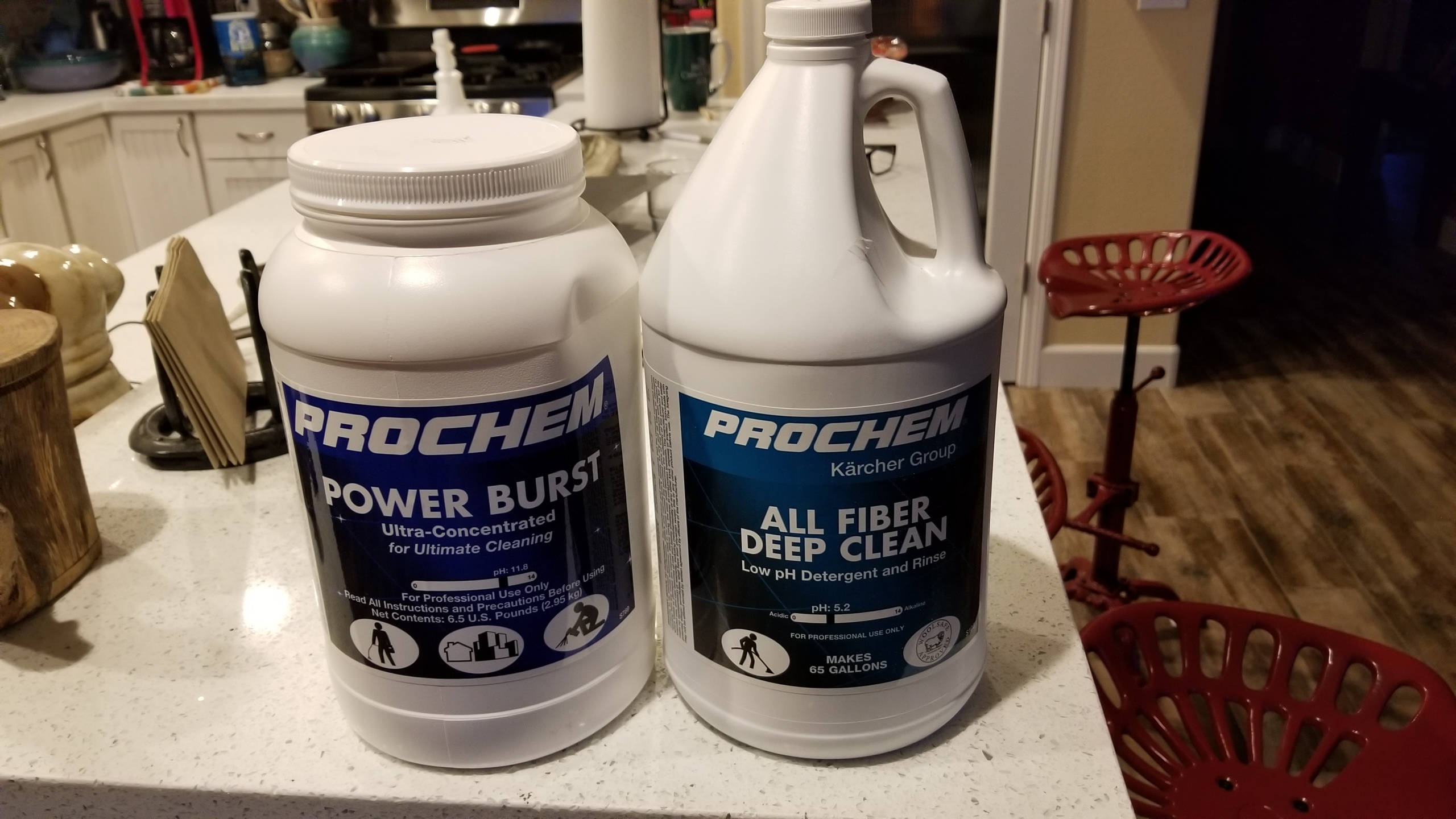

Olson sent me some Prochems to test..
113,218
He saw the photos from my greasy spoon in project the other night and saw that I had to run a solvent and oxygen booster, he said I don't need any of that, just run these two chemicals and then clean the restaurant side by side with the other products and go back and look in two weeks to observe...
Have any of you used these two?
San Francisco, CA
I've used Deep Clean, as an acid rinse that has some detergency. I like it. Not so much the tipycal PC sweet smell. I use it on wool and as an oriental rugs on location cleaner that will stabilize some dyes. Works well.
Never used with Powerburst and in a restaurant setting. It will likely neutralize Powerburst's (which will do the heavy lifting) high alkalinity, yet still act as a good acid rinse with an extra kick and soft feel when dry.

Power burst high ph enzyme prespray probably great on restaurant grease!
Ask him if it needs boosting would he use ultra pac for solvency!

Powerburst works great but not very economical at the label suggested 4 oz./gallon.
All Fiber Deep Clean also worked great, I just hated the scent so I stopped using it.

been telling you dipwads forever Powerburst is the chit
but you morons would rather play musical chairs jumping from one juice de jour to the next de jour flavor :icon_rolleyes:
and claiming they're all the "greatest evah"
Only been one de jour juice that's come close to Powerburst over the yeas ..Flex powder

From the SDS's active ingredients, It looks like a normal phosphate powder cleaner with powdered peroxide mixed in. I don't see how it could be any better than code red, grease eraser with peroxide, flex etc.

Like Larry, used p burst for years on nastys but switched to flex a few years ago bc of the smell and bc we don't do a ton of true nasty jobs. Used deep clean as everyday rinse for two years but I went back to an acid rinse because we were getting more wicking calls with the deep clean
