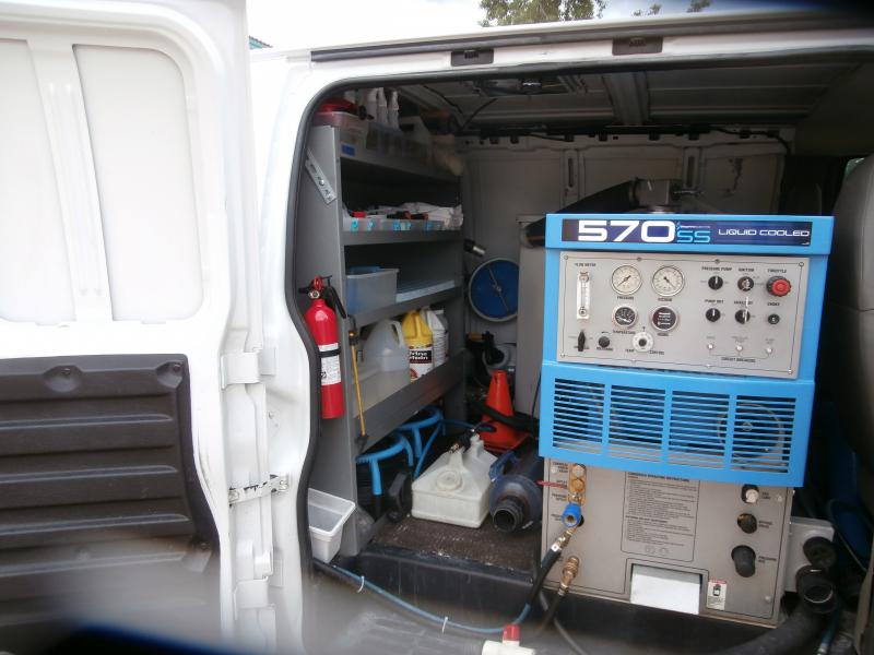

there is nothing wrong with that machine...there are bunch of them out there and they are running hard and strong and the guys behind the wand are happy as hell..........its only hiccup..is that it produces so much heat and it has to have a few adjustments....
a slide in machine that can produce that much heat and vacuum with out a secondary type of heating system....thats a problem most guys would love to have.....

I know...but I run one of these machine and know first hand what it does...and it is not as bad as what it sounds like....

570..your not going to find a better machine out there......

I have heard nothing but great things about all this heat the 570 creates. I've even seen the temp gauge pics way up there. It always makes me think about running Adam Hales V that he sold to my friend. My truck was in the shop for some trans reapair and I ran it for 5 days. The water temp gauge would climb to 260 really fast and sustain around 245. Problem is, running my wand or the hoss at 100' my inline temp gauge never once got above 200. And was far from sustaining that. It did sustain 170 ATW. and the outside temp was around 40 degrees. Point is, temperature gauges at the machine can be rediculous. The TCS is going to give you true sustained temps. So far nobody has given any evidence that the 570 can do the same. If your happy with butler heat you will probably be happy with 570 heat.

it would be easy for me to put a temp gauge at my wand or zipper and show what it can do...but I really see no point in it...there is a large amount of these machines out there...and everyone that runs one of theses more then agrees and will tell you the exact same thing...it can produce and hold some remarkable heat and deliver it to you..
and no it was not cold out side..we were in the high 90's that day...
