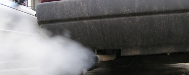

Ofer did the truck in general smell from exhaust residue? I know those that burn kero in their heaters stink and leave a nasty film on everything but always wondered about heat exchange units that were diesel powered.
No. I had it exhausted out, I installed an exhaust pipe just for the machine that was run parallel to the van's exhaust pipe, all the way to the back. Never smelled from Diesel in the truck.
However when there was an air draw into the house I was cleaning, even if the van was parked a fair distance away, you'd still get that diesel smell.
I hate that smell. I'll get behind a 4x4 with a huge exhaust pipe and nearly die from diesel exhaust before the light turns. :cry:

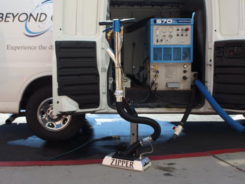

We have a 2015 Diesel Promaster. Need to buy a truckmount unit. Was able to check out the Saphire 570SS this week. Can I get feedback on the TCS Chief II Diesel. It's between these two machines. Just don't want to leave any stones un turned.
Can I just say what a huge blessing this week was for us and our business. You guys are a pretty amazing bunch of people.
It's pretty easy to get sucked in to Mikey's board.
I did not read this entire thread ( i really do not need to )..but what I can tell you is that you are never going to find a better combination the the 570 and the zipper...the 570 has no problem delivering the heat and the chamber on the zipper holds that heat as it is flushing out the carpets...and between the vacuum that the 570 will give you and the design of the zipper...the carpets are left the driest I have ever seen them....
