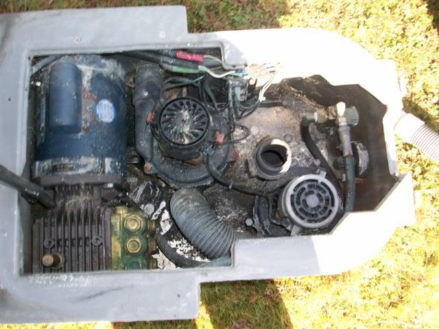

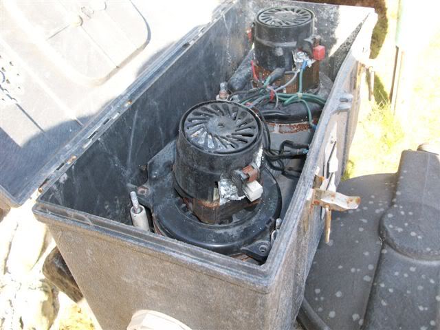

I don't agree with what you say about pumptec. Garbage and in my opinion, one of the crappiest pumps made for any form of longevity. Here's a set up I used to use. (Pardon the singeing) This was in my old Ninja, General pump, 2 two stage vacs in the unit and a "tool box" booster that sat on top or wherever you chose. I know 3 cords, but it could do OK without the vac pack. This machine ROCKED with the booster for a porty set up. (Ask Mr V, he saw and operated it)
The vac pack teed into the head of the Ninja by putting another hose barb on the opposite side of the head.
Now that was a booster, and it stayed within 4 feet of the base. Four 2 stage vacs. 2 in 2 sets of series to a parallel. I've fiddled with every combination of vacuum and this was the most power, hands down.

Hi Willy,
We had as quad vac at connections last year, 2 in series and 2 in parallel. (180" and 200 cfm) Too many amps(20 amps per cord with only 250 psi pump) made it too specialized of a machine. With our new motors we have 148" and 230 cfm at 15 amps per cord with a 500 psi pump, 1.6 gpm is just better in my opinion. If plumbed properly the Pumptec pump is very reliable and easy to rebuild. Thats why more manufacturers use them in portables then any other pump for high pressure (200 psi and above). Though the General is a good pump and a great company, an oil bath pump like that will leak oil if turn on it's side, which is what some operators do to portables, thus not practical for most of the market.
