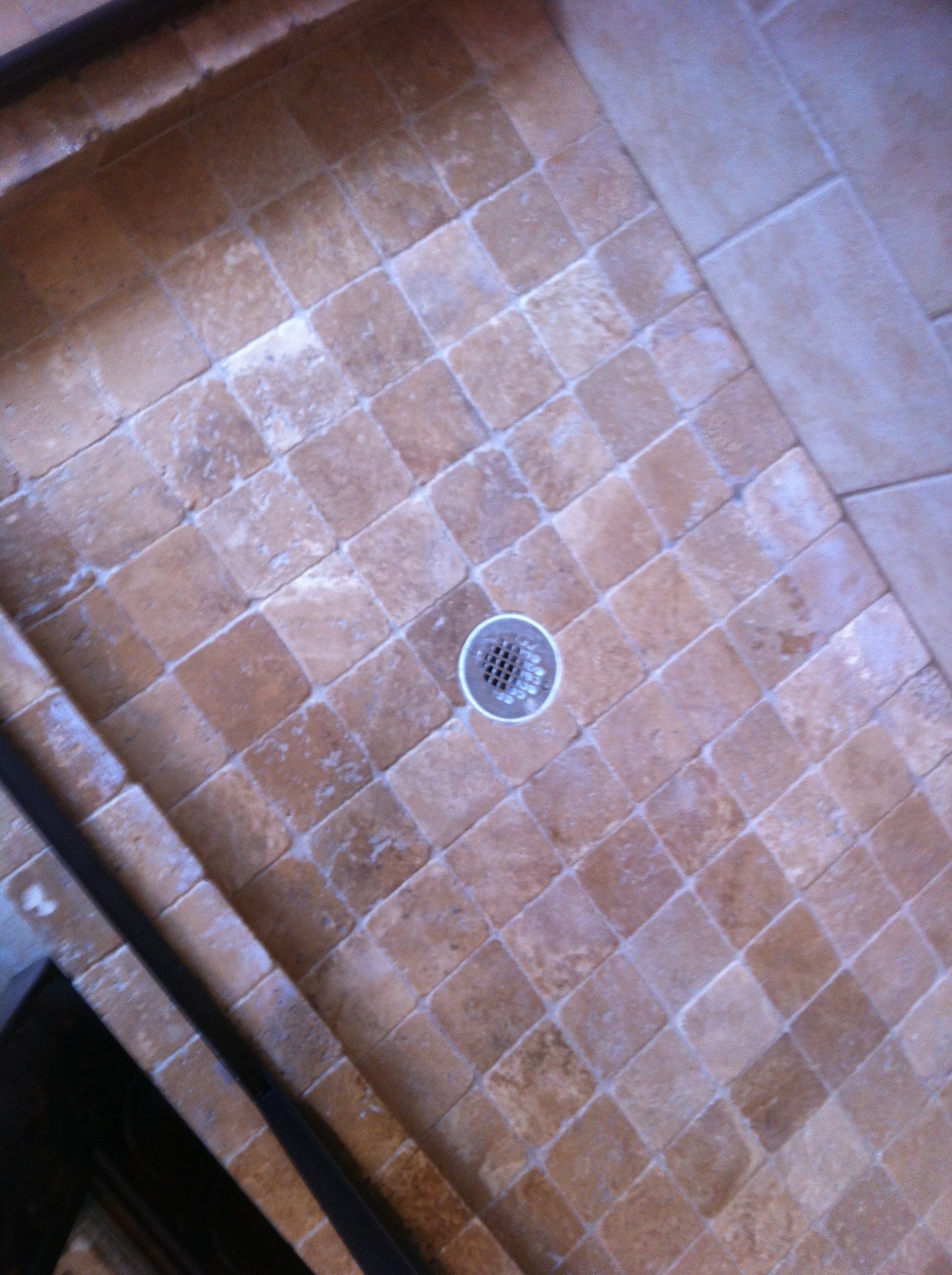

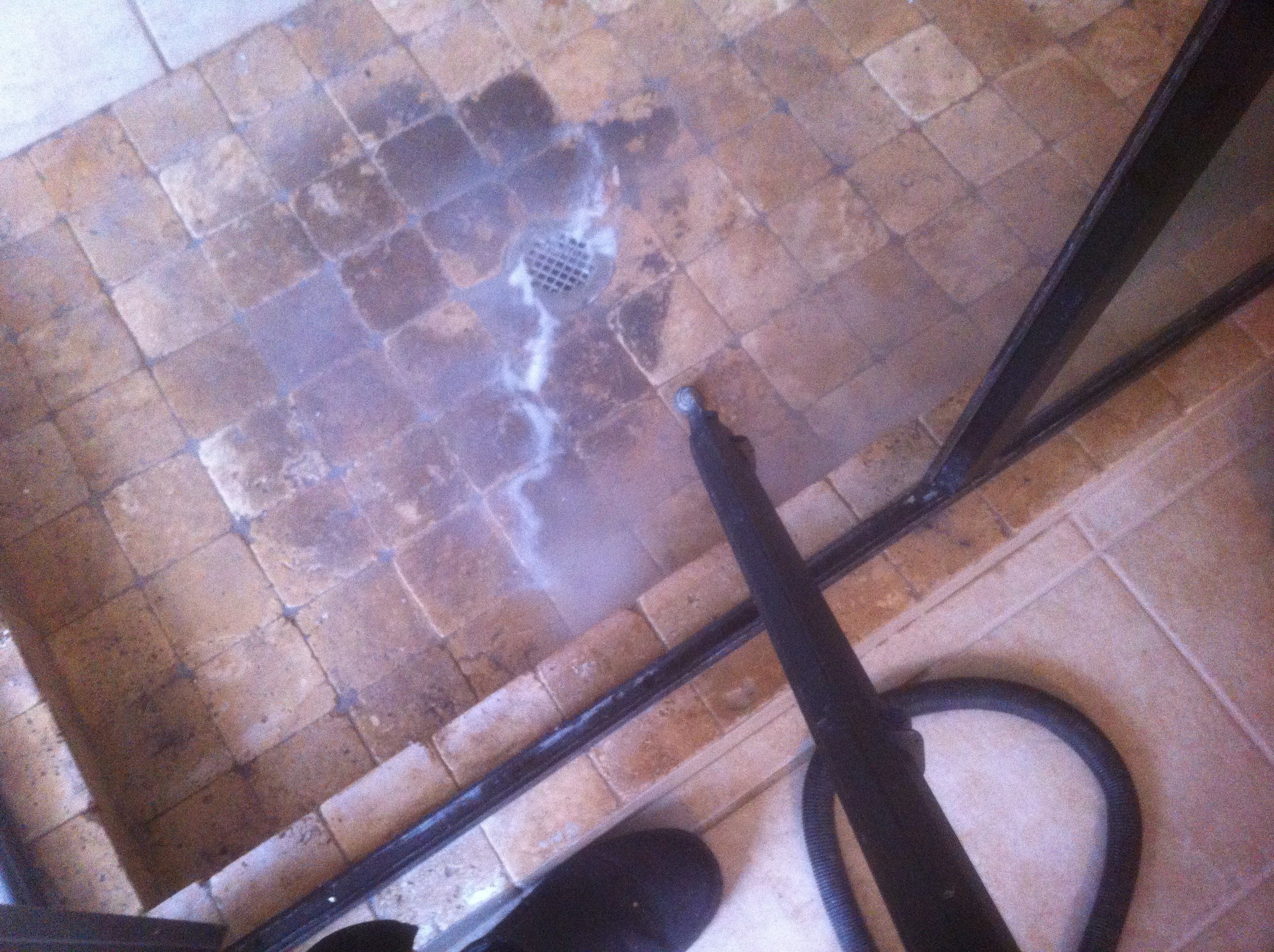

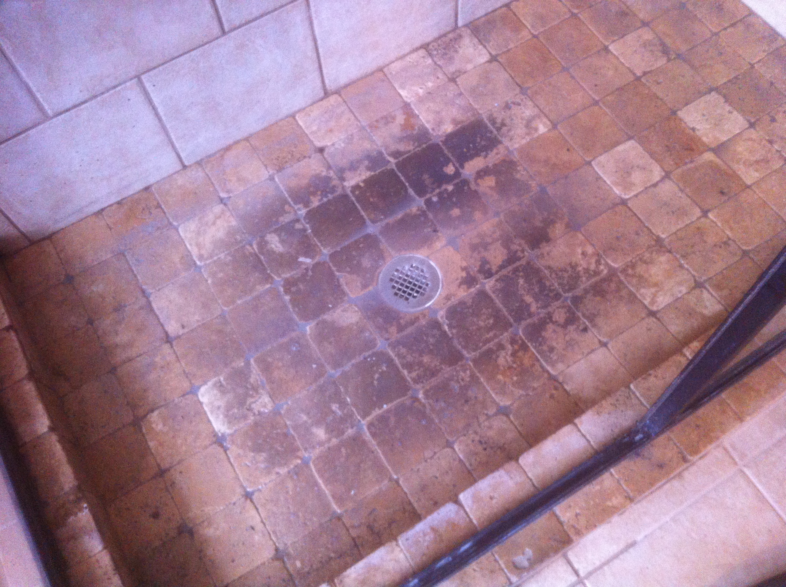

It will clean.
AB5519E4-2877-4A63-AA2E-3E7983A6D59F.jpeg 21B552F2-99DD-44B6-9025-B0DFDE64C889.jpeg 4D3021D6-CB5D-4745-884D-291C27BA636C.jpeg

Bjorn, How does that unit you speak of work on natural stone shower floors with the soap scum/ foot oil soil circles.
Does it have enough "flow" to rinse the contamination to the drain, or do you have to wipe it with towel?
at those temps most everything is vaporized.. but keep a shop vac and towels close by. Some showers TM is better but we do a lot that are just needing a good steam clean, so not occupying the TM and slowing the whole job down is pretty profitable.

Stephen, that’s the classic soil circle... was that straight steam or chems then steam? Awesome pics...
Vaporize? As into the air I am breathing?
My machine can inject cleaner into the stream, so most likely I had some dilution of Viper Venom. Mostly, it is the vapor which disrupts the soil at about 90psi without the high pressure of a Gecko or spinner. Vapor also sears the surface, making regrowth of mildew a bit less likely (as subsurface porosity is penetrated). Nothing is perfect.
Where it really excells is in the cramped or otherwise inaccessible spots.
For some reason FB won’t allow me to copy a link, but if you find “Act One Cleaning” www.facebook.com/actonecleaning you can see several videos of vapor steam in action.
