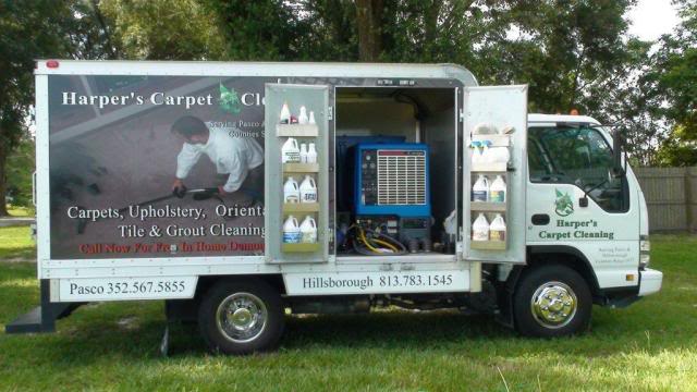

the machine and the truck are everything I hoped they would be.....and then some....the set up is exactly how I want it...and need it.....the only thing I have in my plans is I am looking for a certain type cabinet to put in the back to organize a few more items....other then that....there is nothing I need to do to it.....it don't have a lot of useless bling...but they are both a work horse and they get the job done.......
Jim,
If I remember correctly...? you have a "roll-up door" @ the machine...!!!
But you have "Hinged" doors in the rear... :!:
Don't under estimate the VAST amount of storage available on those DOORS... :idea:
I believe the left rear door ..has a shelving unit about 8 inches from the rear door..?
So there is plenty of room to mount shelving on those rear doors...!!!
This will leave you with more "OPEN floor space... 8) You can use "self tapping" 1/4 inch
screws to mount the shelving...OR...Drill all the way threw the doors & counter sink the SS heads..."Then just cover heads with the extra "vinyl wrap" material... !gotcha!
"We were able to ELIMANATE a three tier ss "floor mounted" shelve by doing this..." 8)
Ps..with your neck issues, It makes a lot of sense for you to have MOST frequently use chems & tools with-in arms reach. :idea:
NO climbing in & out of the truck for frequently used item's.. :!:
