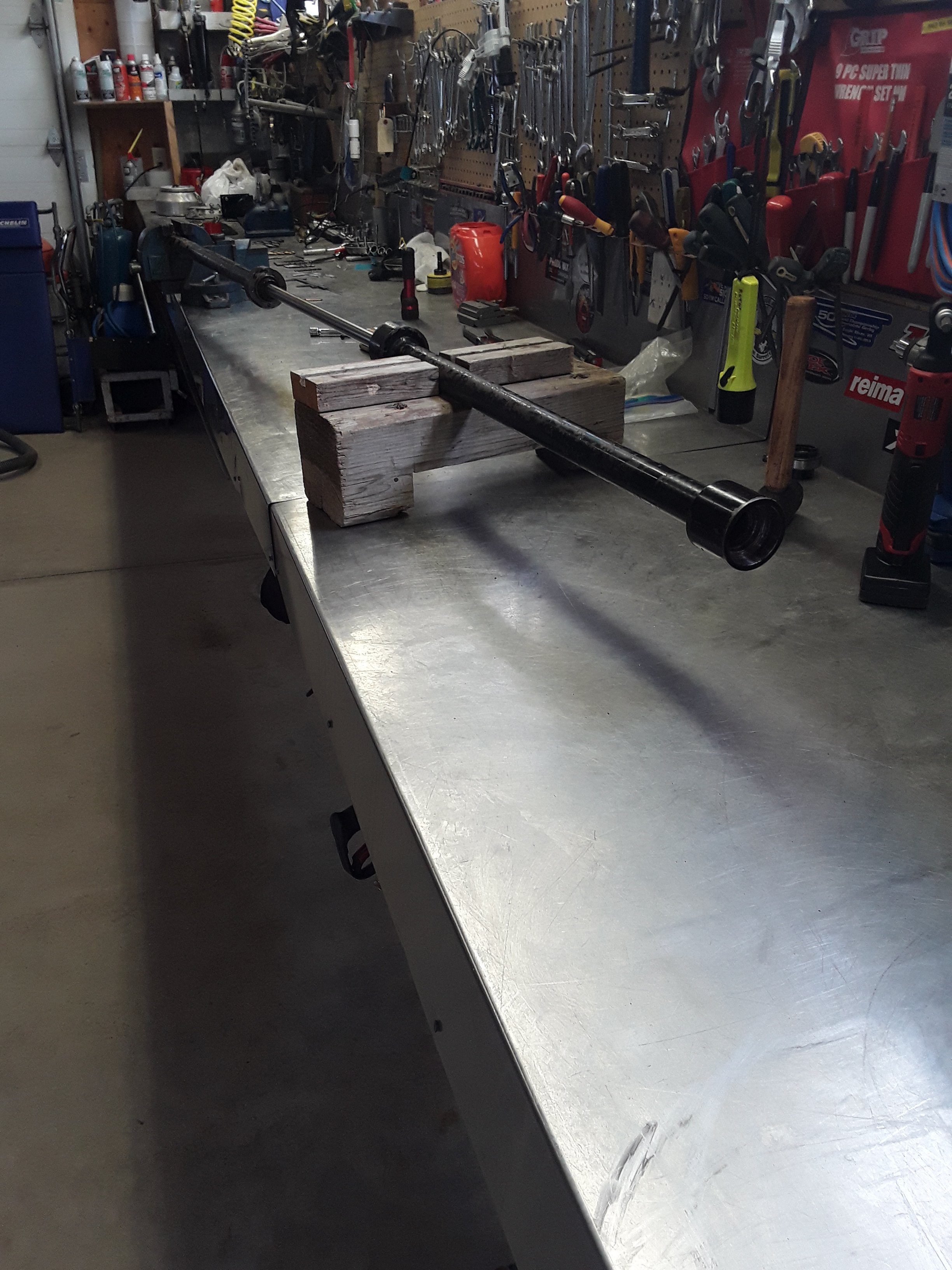

I am no expert with the Butler units, but it probably will. I hope so, because I am in the process of refurbishing the drive shaft on my 2007 Butler.It was easy enough to split the shaft housing and remove the rear concentric bearing.
The difficulty i have run into is the front bearing and not being able to drive the shaft backwards for the removal of the other two bearings.
I have taken it to a machine shop because I don't want to damage the shaft.
