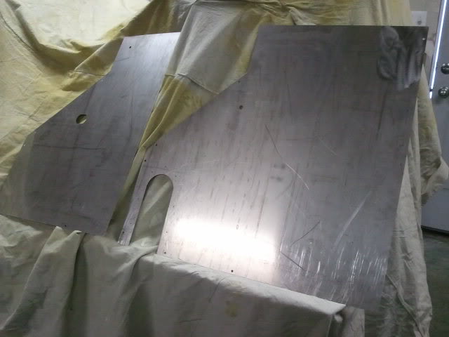

DAMN...i went to the waterjetters to pick up my last two SS panels........today...
i usually get a brush or satin finish...but THIS time i tol them i wanted MIRROR FINISH.......
what came back was factory finish with the alloy codes still printed on.......
TWO CHOICES:
sand (1000 grit...then 1500)and wheel for two fulls days......... OR
powder coat over the Stainless???
i believe that i'll powder coat it unless one of you brainiacs can talk me outta it..............

My two NEW stainless 18 Ga Stainless panels......jus cut out
next time you see them they will be WAY different
