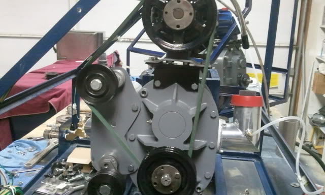

I put my blower flat on the floor of our direct drive 1.5 years now and still have the same 2 "GREEN" B belts that BaWb told me to use. I dont see the need for the angle :|

belt drive IS very forgiving.........!
iv'e never ever had to replace a "B" Gates Greenbelt.

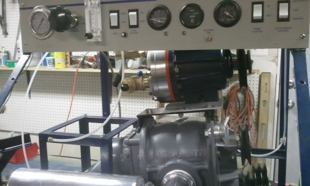

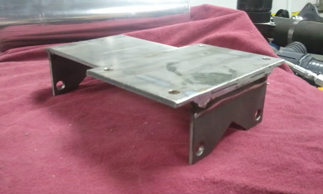

My pump bracket..
all buzzed together...
i'm painting it while yor reading these.......

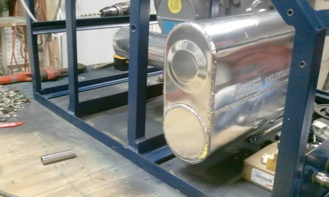

Where would one go to get a muffler ceramic coated? and what model# is that muffler?
not all powder coaters can DO ceramic coating....the temp is WAY different!
but they can tell ya WHERE to get it done!
I guess i SHOULD remember that Flowmaster #......but i can't...
it's the smallest 3" offset in- offset out they make.....i cut the out off and tiged it shut and then holesawed a 3' hole in the side to go out under the truck........
they MAKE nice shiny Stainless ones for about 99 bucks

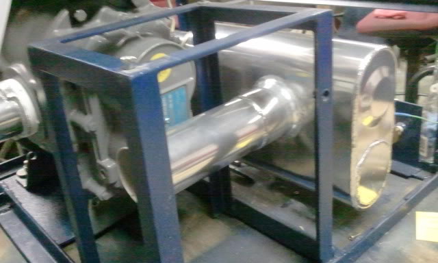

that is Flowmaster # 43043..
see how i tigged the exhaust end shut and opened up a hole facing the back...

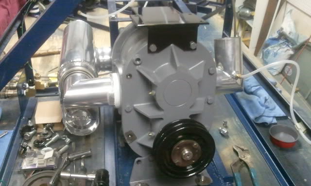

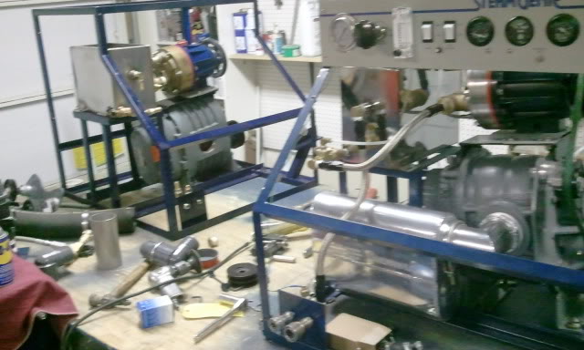

Why the 90 degree bends right off the blower? Why not use swooping radius bends and a slightly larger footprint and enjoy the increase in efficiency? as a man who has worked with headers and performance intakes, you should know the turbulence caused in a 90 degree sharp bend like that and the resulting loss of efficiency and performance.
Take care,
Lisa

truckmount girl said:
Never say something is your last, 'cause you never know what opportunities may come your way. goes for truckmounts and wives.... !gotcha!
Take care,
Lisa
a 90 bend is of no consequence..i know you THINK so....
but it ain't...all waste tanks have a 90 inside the tank......
'cides i'll take advantage of the tens of thousands of dollars put into R&D by Steam Genie.....

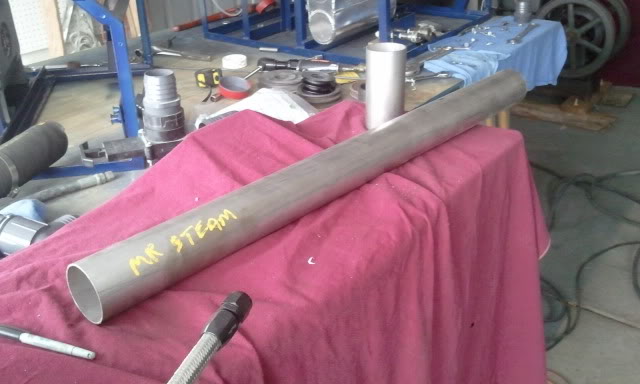

a different "footprint" would be impractical for the other components to fit together...funny that should come up as i jus went down and picked up my new Stainless tube......
truckmount girl
1800greenglides
8,880
Sun City, CA
Lisa Smith
How can you, of all people, say it makes no difference?! You KNOW it does and not all waste tanks have 90's in the tank either...mine didn't.
Would you expect an engine to perform as well with intake and exhaust having hard 90's? Why do you think you have more suction if you straighten out the loops in your vac hose?
Take care,
Lisa
Take care,
Lisa
Lisa...you should SEE some of the wild ass headers my mechanic makes for the various kinds of race cars they build....sometimes they build a tube header wit a 180 degree
bend in it jus to get around the steering shaft..........
you do wtf ya GOTTA do......
and don get me going about some of the wild ass turbo plumbing they make....

So you admit it does make a difference, you just are skeered to work outside the SG parameters.
I'll pick the fence.
Take care,
Lisa

bob vawter said:
[quote="truckmount girl":1rn8u3c0]How can you, of all people, say it makes no difference?! You KNOW it does and not all waste tanks have 90's in the tank either...mine didn't.
Take care,
Lisa
and don get me going about some of the wild ass turbo plumbing they make....[/quote:1rn8u3c0]
negligible difference.......!
