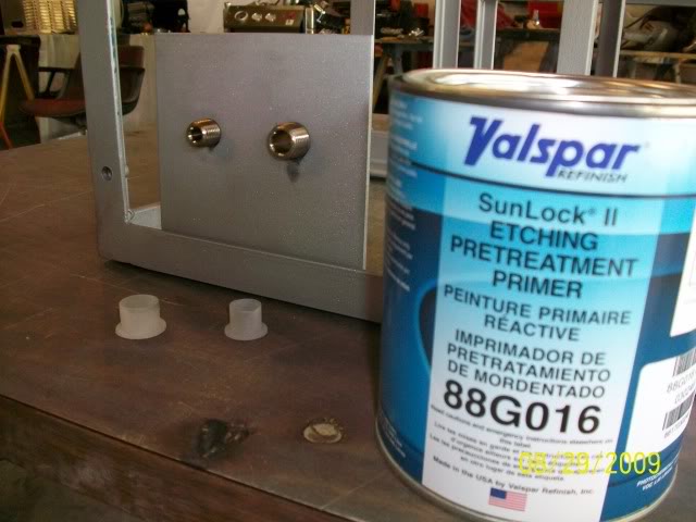

first thing is to build a pump bracket...

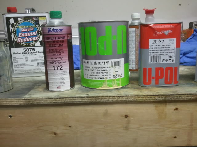

is THIS new enough?
ain't she a pretty 47
ceramic coated..inside and out!

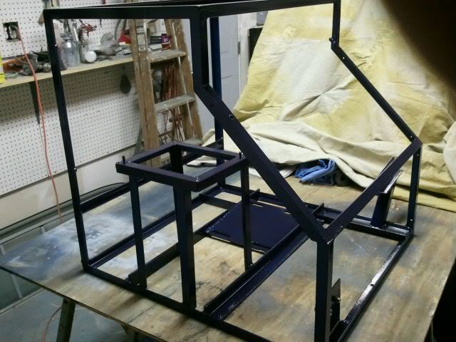

The frame,,with stainless nipples.
bullet-proof epoxy primer

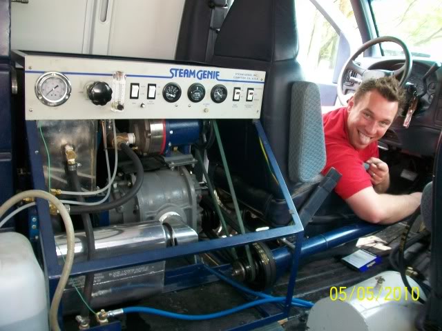

Look DUane..heres what i tell the guys that call me...
go out and SHOP THE SHIT outta an 02 or earlier...get a low milage like CRASH did...
$4000.00...put a $6000.00 Genie in it....and you got a bulletproof machine for 12 to 15 years...for about $69.00 a month......that WON'T blow up or make you smell like diesel fuel all day!
they CAN be put into brand new chevy vans..but it's a lot more work!
THIS is CRASHES van..an 01 wit 72000 on it that he got for under FOUR GRAND....

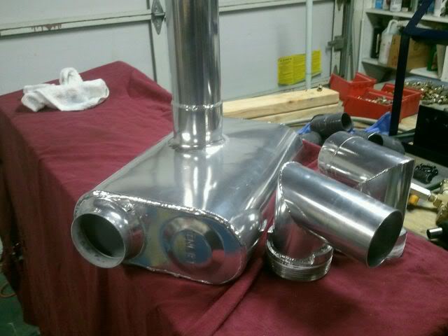

it takes TWO expansion chambers to knock the top and bottom of a sine wave down......
you see one right at the blower and then i put another underneath the truck....

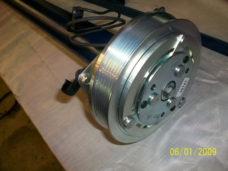

a picture of the Pitts clutch......
in TWENTY years...i've NEVER had one go bad....and i ran my waste tank on total lock down for years....
