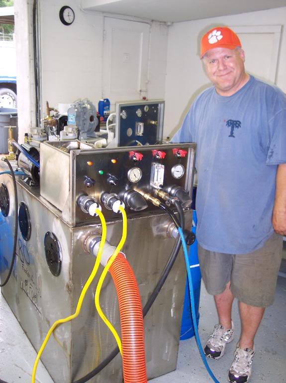

I'm designing an oil- fired (30 Kohler / 47 Roots) system right now for one, to be delivered the end of this month.
I'll post pictures when it's done.

No recovery tank. Continuous pump out. Floor- mounted UltraFlow filter, with dual 2" ports and a single 3" connector to the vacuum tank. This one will be a serious, dual- wand fire-breather, with a couple of tricks to show what a 47 Roots can really do, if you tweak it some.
That's part of the "secret".
The machine is 21 inches wide and 53 inches long. The vacuum hose reel is 45" front to back. That leaves 6" wiggle room, front to back. With 58 inches, side to side, that leaves 5 inches..
Look for some real "tricks" in this one to make a nice fit, including electric rewind vacuum reel hung high from near the ceiling, wall reels for solution and water supply, and custom chemical racks.

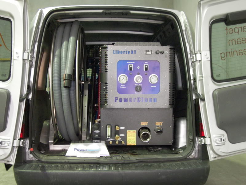

This is a PowerClean Liberty we installed into a GMC combo van 18 months ago. They are slightly smaller than the new Ford mini-van, but we still managed to get a 26hp water cooled truck mount in there, with a stainless steel vac hose reel and waste tank - the front part of the van can still fit some accessories.
It is not ideal in my opinion, as it is still a small van, very small. For a back up, or a separate portable or encap vehicle they are perfect. This client used this setup like it is for over 12 months as he already had the combo van, and couldn't stretch to purchase a new TM and a new larger van, so he used this setup as a 'stepping stone' vehicle, and we now have installed the Liberty TM into a larger more practical van - but it more then served its intended interim purpose.
