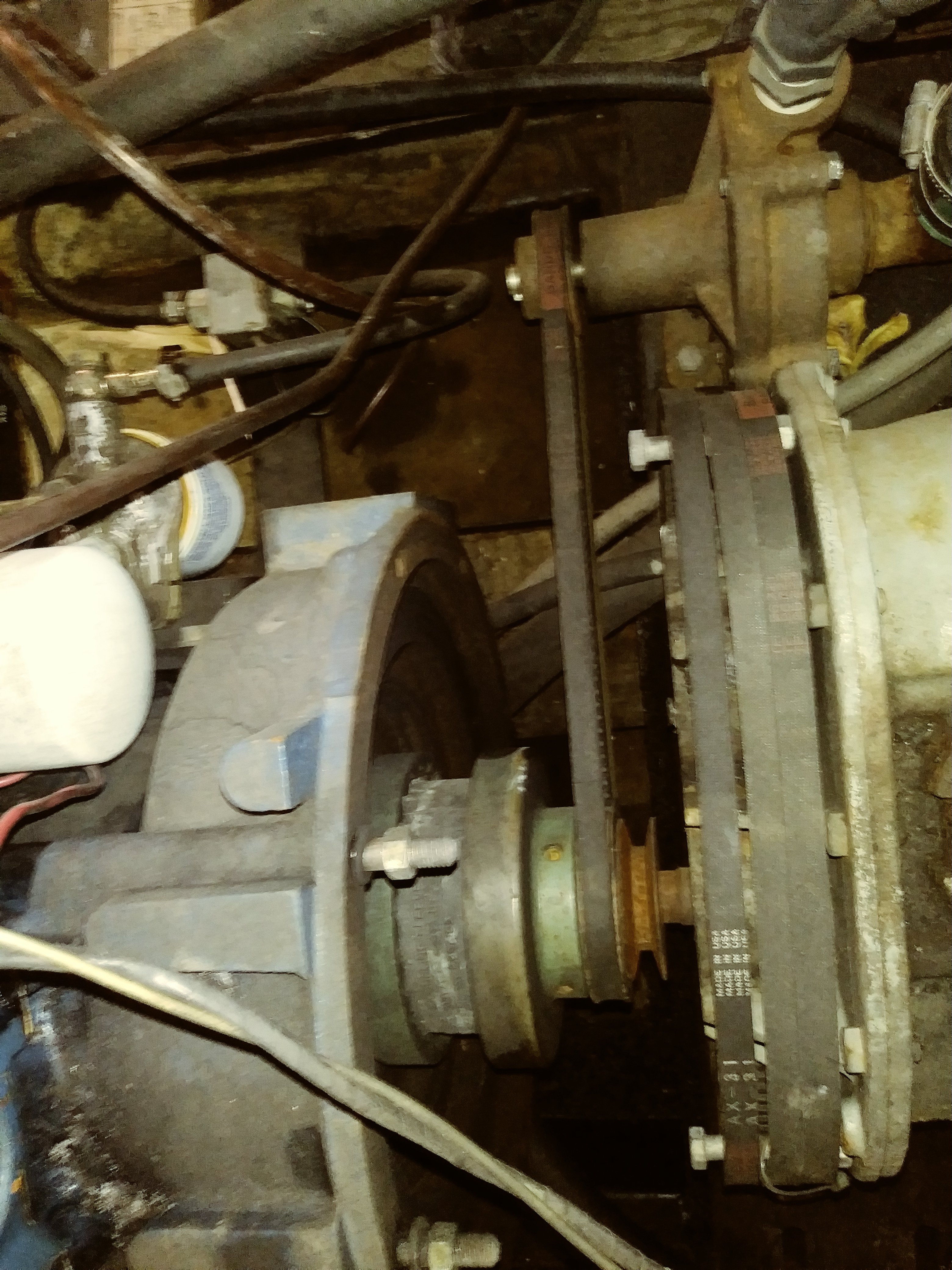

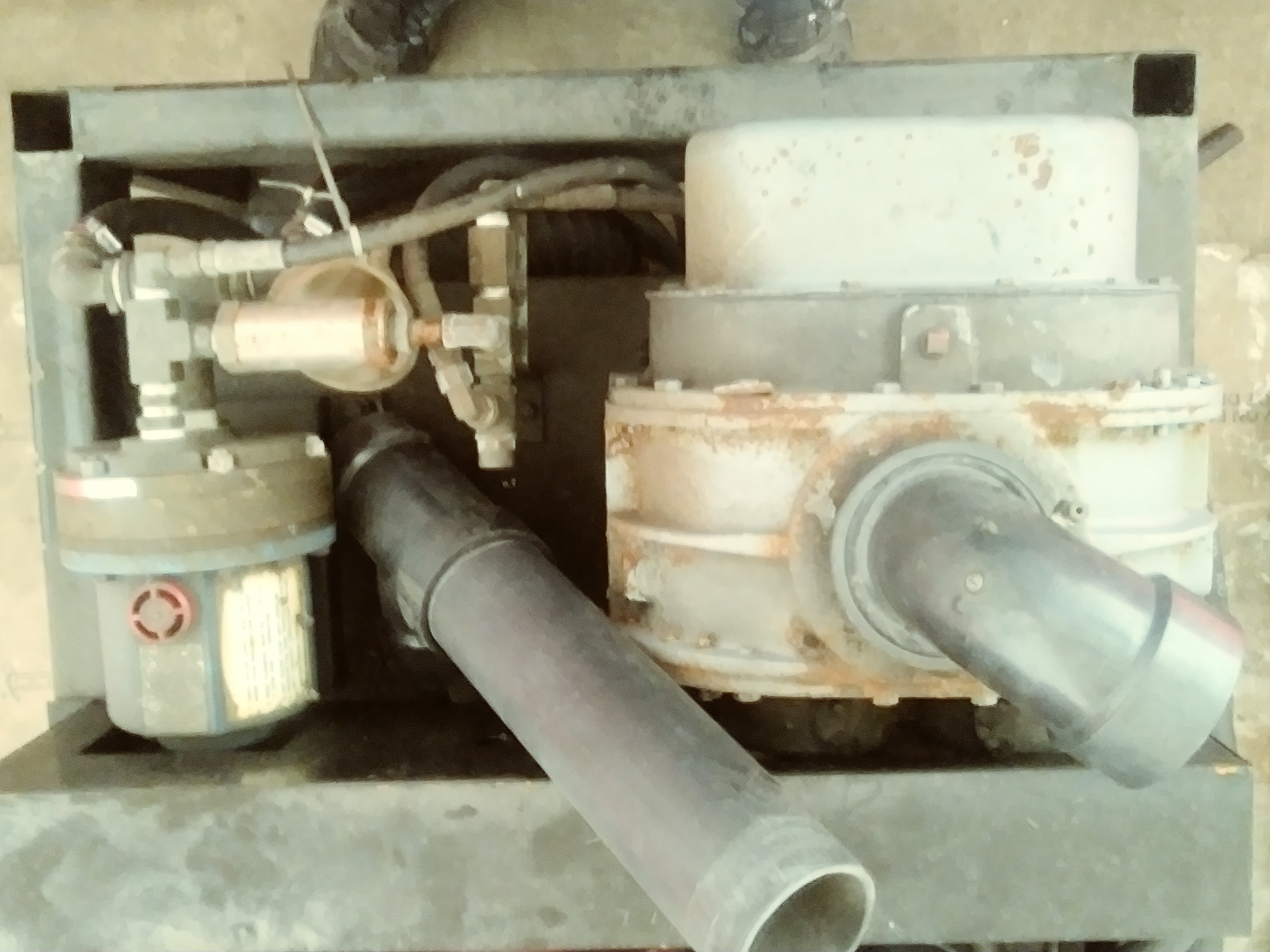

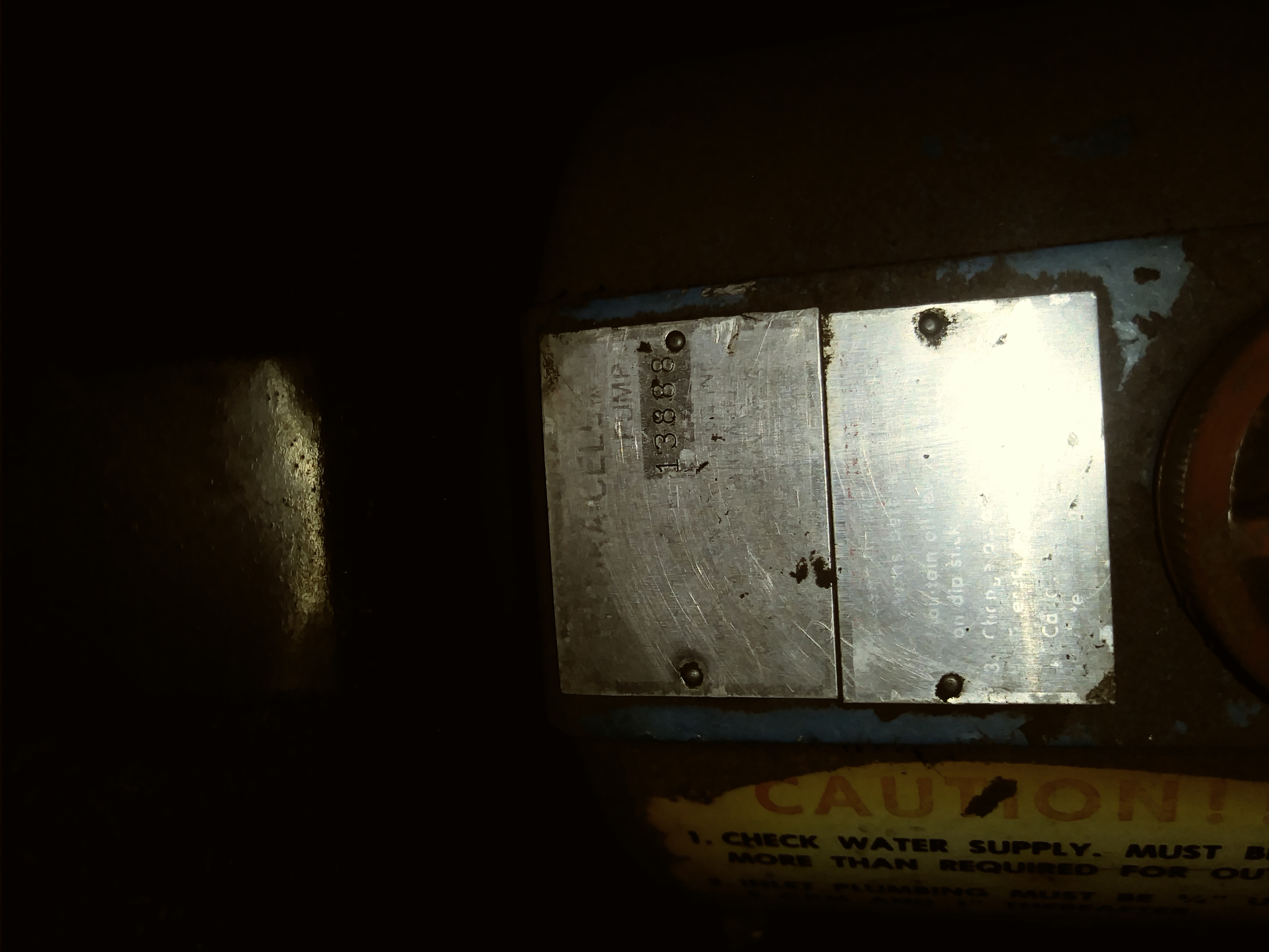

@bob vawter what is that big lever out front for?

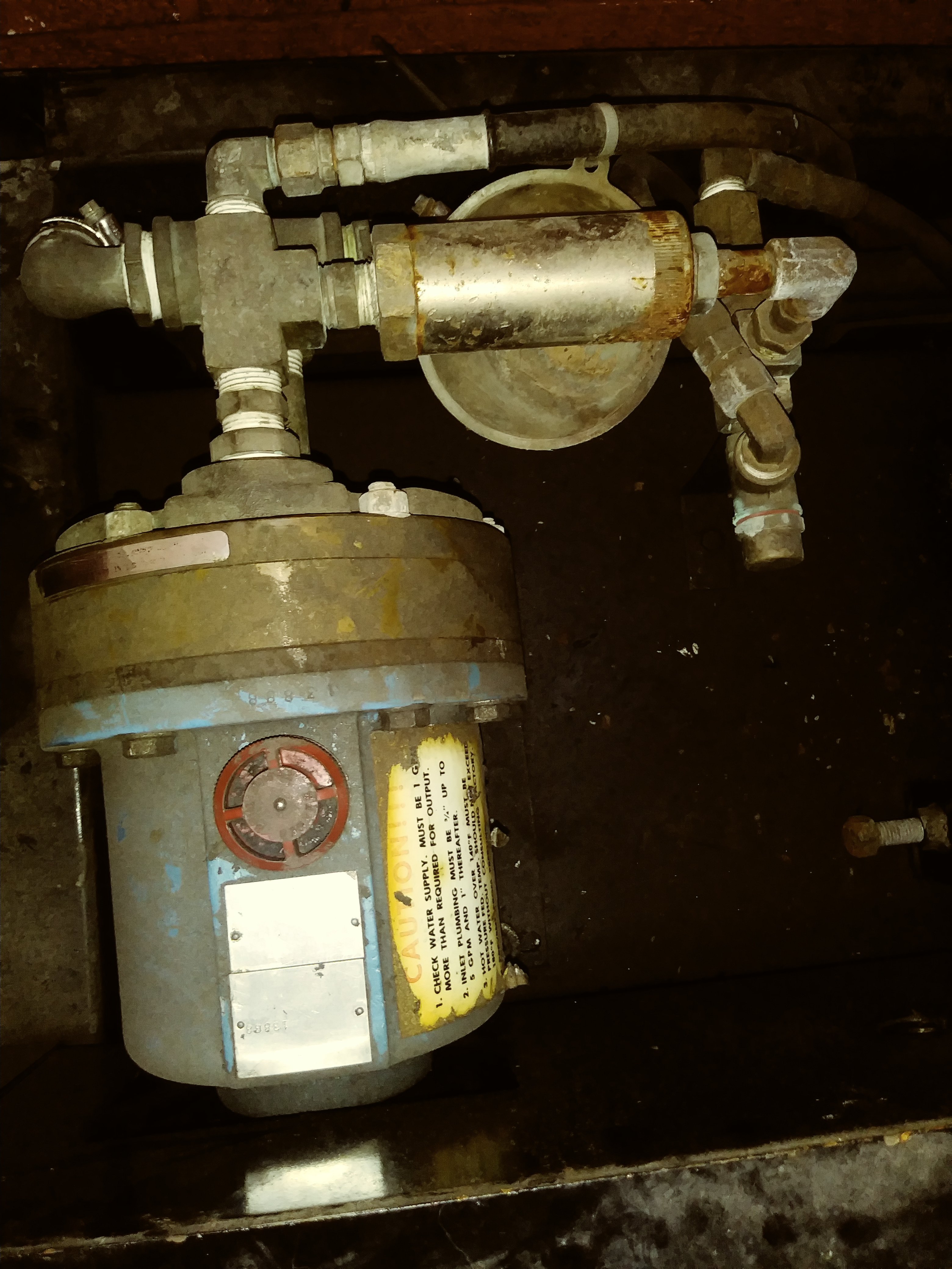

thats the clutch lever...lift up to engage the belt system...cant tell for sure but that looks lik a Hydra Cell D 12 pump capable up to 2500 psi as opposed to the smaller D 10s that i used....

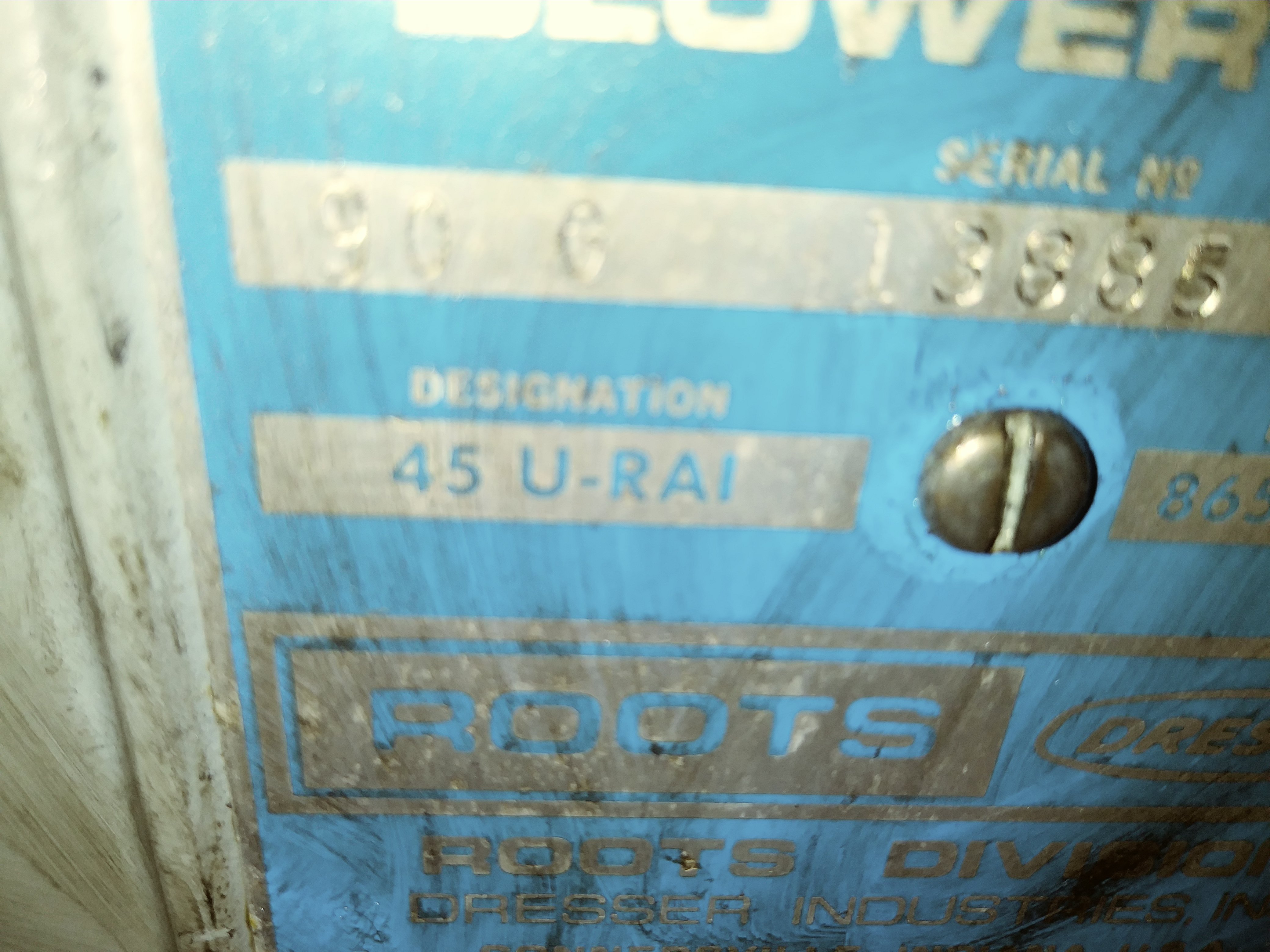

a used D 12 goes for 6 or 7 hunnert then the blower is worth maybe another 7 or 8 hunnert..the motor would require a compression test to be sure
the real question IS: what kinna waste tank? The Bates tanks were really a POS!

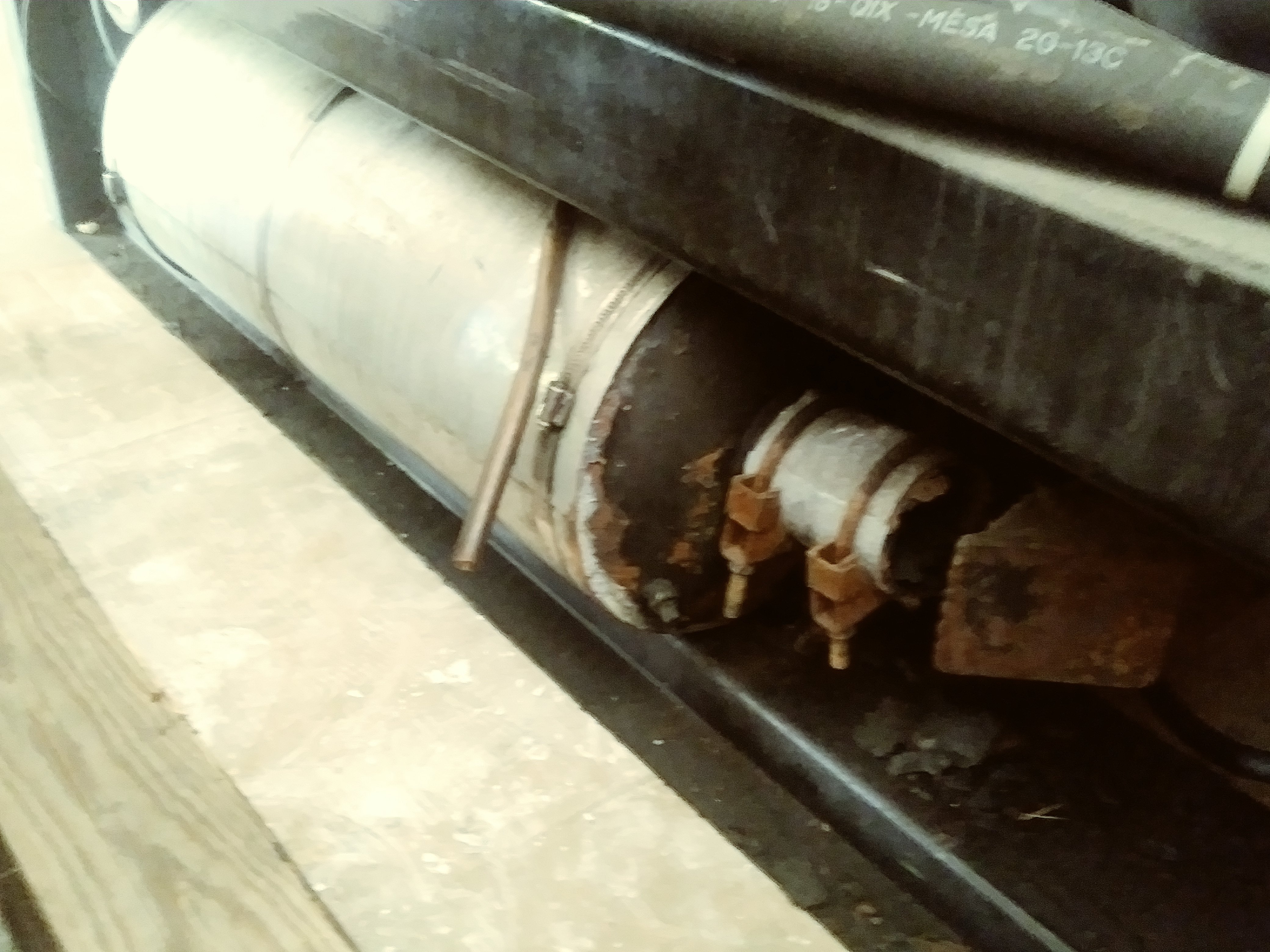

Not sure if the waste tank is attatched,there is a stainless box on the isuzu but not the perkins,there are two mufflers under it and what looks like a black ,thinking fuel but couldnt see the cap anywhere but there is ful in it,i turned it over today but couldnt get it to fire,compression is there,fuel is there but i dont think the plugs are heating up or im not turning something on correctly,hit it with starting fluid lightly but still no fire,engines turnover slowed when either entered intake,im guessing its a wire somewhere,im not a mechanic but i can figure just about anything out if i focus a little and trust me,this thing has my attention,i think im going to end up keeping it lol
