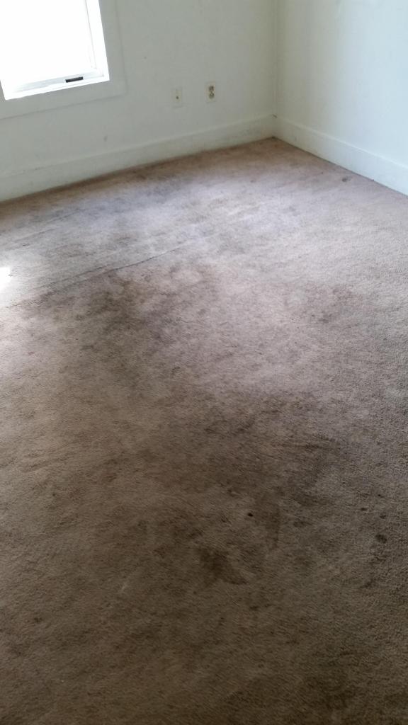

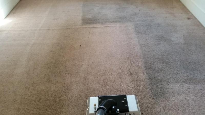

Here is a 2nd floor trashed rental from yesterday that it was way easier to get the Zipper up to it than the Rx-20.
I tried to talk the owner into replacing the carpet as it was junk. Lots of spills, some dog urine, cigarette burns....just junk....
But, he had the mentality of "just fix it up"....Ok
The high flow and the heat trapped inside the dual chamber just seemed to help cut faster.
So anyway, just sharing ....

AAARRRRRGGGGGHHHHH! Look at the mess that cord is in ! NOTHING boils my bacon like that.All twisted and curly- nice job on those carpets even if they are hatched.
I know Willy. Hate that too.
Only cords I have that do that to me are on these CRB's

oof!
better but you need more peroxide and an RE to cook that crap out.
It was so bad, and I had a ton of 40 Volume and putting down chems at 4 to one, and boosted with Powdered Peroxide too.
The carpets were so loose, the RE would have tore it apart.
I asked him how old the carpets were and he said "not that old....only about 12 years old....still good carpet and this is first time it's had to be professionally cleaned after all his renters" :eekk:
I told him it was going to be ugly yet and expect wick backs! :hopeless::dejection:
Were that black stain and wear is off to the Left....is the beginning of the backing as well as brown staining. Treated with Peroxide after too.
The other black dots (and some of the other black) are all cigarette burns and ash burns.
Yuck Job!
