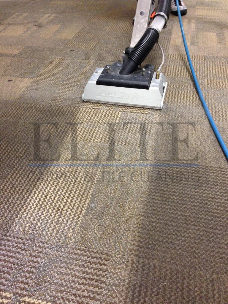

This time we just presprayed (using Harvard products PM me if you wand the formula) , no agitation (intentionally) and went to see what the Zipper could do.
It did great. Definitely a time saver for our application.
There were some areas the High Flow Prochem Titanium had a hard time cutting, but the Zipper would buzz it right out. I think it is able to keep the heat enclosed a bit more, but also, the angle of the jets is pretty dang spot on.
Set up of the Zipper is way easier than thought.
See Erik's video for basic care and set up. Set up on commercial carpets, be able to slip a business card under and have it just start to hold the business card. (oh and take off the weights that are on the zipper....really will not need it)
For residential carpets, set the back glide up to about 3/16" from the FLOOR or Hard flat surface you are using to set distance from....Then go clean the carpets. You can mess around with it a bit more, but it is just minor tweeks or adjustments maybe from here.
We used the same setting on 2 different height residentials yesterday to test....did great! (again taking the weight off the unit was a big help compared to our first run)
The larger unit is harder to use on residential, but I really don't mind. If going to do more residential and you want easier, get a smaller head one and maybe ergo handle.
Now for the Videos, lighting is terrible, but hey....THE DANG THING PLAIN OLD CLEANED AND IN ABOUT HALF THE TIME :)

Zipper is a flushing machine... without the need to try and feather out weird "clean rings" at the beginning and end. AND it goes forwards :p

I currently have a rotovac xl on the truck. In my opinion the zipper is a commercial tool where as the rotovac is a residential. Not that either of them can't clean both but it's just not their strong suit. The zipper is definitely a high production tool. It's allowed me to decrease my total job time by an average of 40% in a commercial setting.
