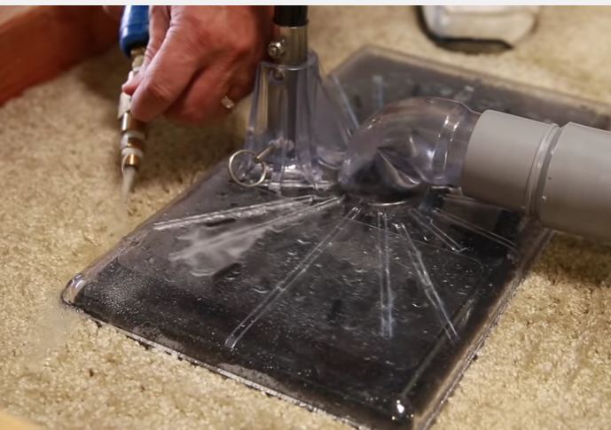

Our solution on Pet Urine is Odor Attack (powder with 3 main ingredients).
1. It starts with a strong Oxidizer for stain & odor removal.
2. We add an actual Enzyme that is compatible with the Oxidizer (most are not).
It is not a bacterial product that slowly produces an enzyme
(which requires the 30 minutes that Tom mentioned)
3. Finally, we use an Effervescing agent to suspend the entire lifting process,
and allow the complete rinsing that Tom also recommends.
A Water Claw with a separate hot water Gunjet is an ideal rinse process that we like to use
