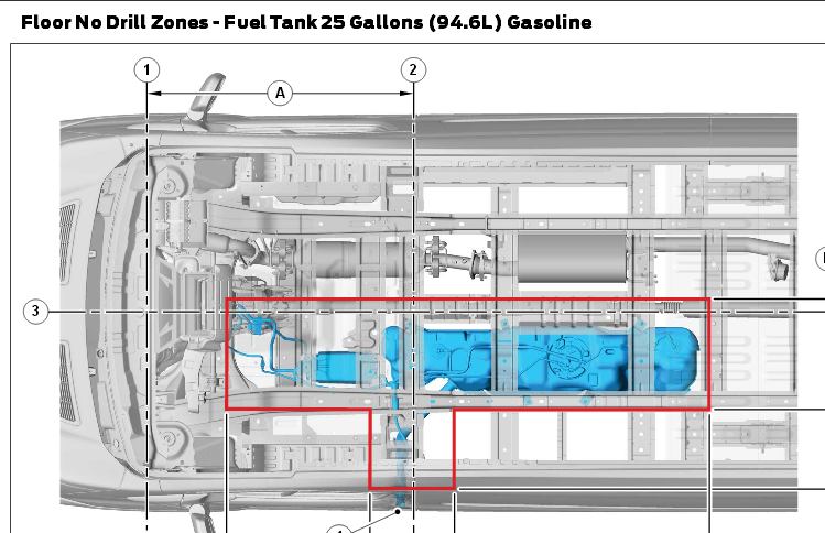

Just to update this thread. I emailed Prochem asking if what was stated here was true and that a truckmount could not be installed in a Ford Transit.
Timothy DuPont, National Service & Training Manager, responded that truckmounts could in fact be installed in a Ford Transit but that a subframe would need to be made by the installing dealer. He also included a link to the Ford Body and Equipment mounting guide here:
https://www.fleet.ford.com/truckbbas/topics/2015/2015_Transit_BEMM_v1-0.pdf
along with the "no drill" diagrams found on page 133 and 135 of the above pdf

Anybody got any actual dealer estimates to add a Transit "subframe" ???
We looked at the 180 pages of Ford documents and determined that there would substantial additional expense,
to comply with all of their requirements.

Fred;
The "no drill" diagrams above the large area above the fuel tank . . .
and the limited holes usable in the existing frame members.
That is what makes a subframe usually required to mount a slide-in TM.

Current vans also have "no drill" areas in their service bulletins.
I have never seen a no drill diagram covering this much cargo area:
Also any steel box subframe will add $600-$1000 to the installation cost,
and take away capacity under the TM.

Michael;
Since our TM's have a flat mounting bottom across the entire van . . .
the weight distribution will be ideal.
The difficulty will be attaching to the few mounting holes in the frame.
In our case, it will probably be steel plates of minimum height to van mounting holes.
It will limit severely the flexibility to position the TM where the customer desires.

If I remember correctly, Duane installed a TM into a transit but had to reinforce before doing so. Now what that entailed? No clue.
