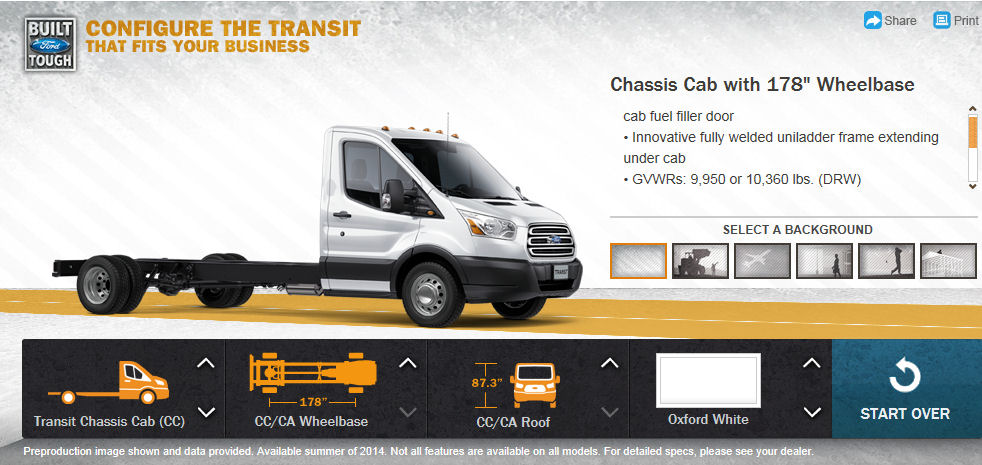

Are you guys talking about the little transits? The new 2500 and 3500s definitely have a frame. Look at the dual wheel cutaway versions. The little ones are a different story. But I'm pretty sure a Rage is the only machine that would fit there anyway.

Buy the chassis-cab, install box, drill holes anywhere you want....

I believe the DRW models are the only ones with actual frame rails. I've looked under the SRW models and they do not have actual frame rails, it's a unibody with reinforcement boxes welded along its length in various places.
When is spoke with the various direct-drive manufacturers they all said they were going to have to design and build sub-frames to accommodate the new unibody vans. Nissan and GM are apparently the only ones offering full box frames now, and when GM switches to the new model Nissan will be the only one left.
