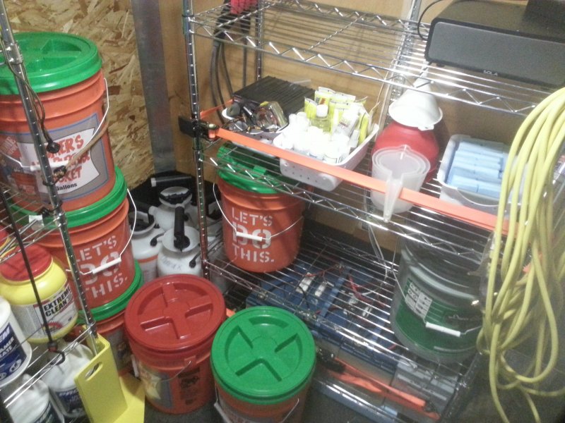

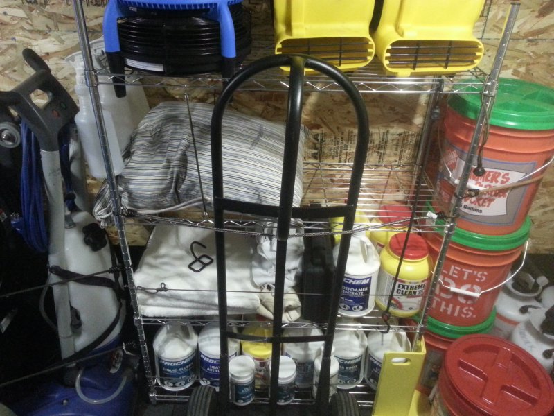

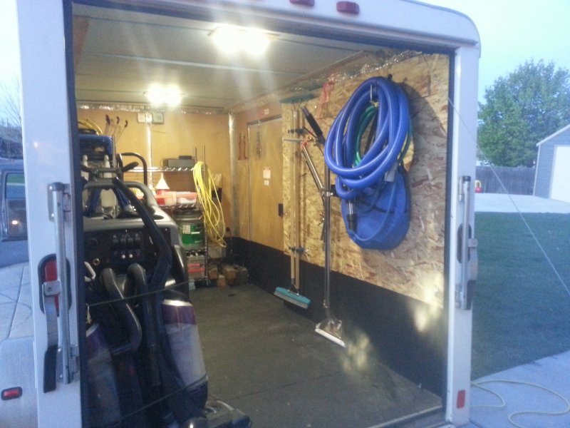

The pillowcase looking thing is a clean rag sack. The buckets are used to haul water and other things. I use one for dirty rags and towels, one of them is the trash can, etc...

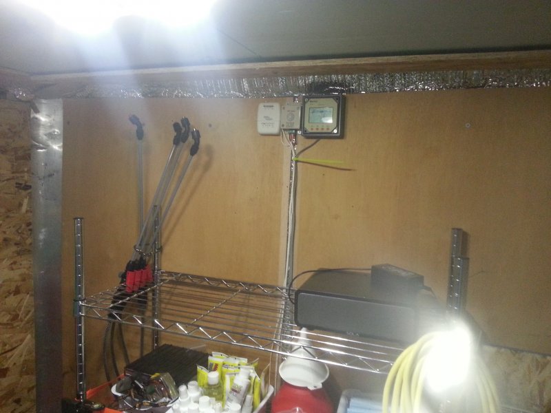

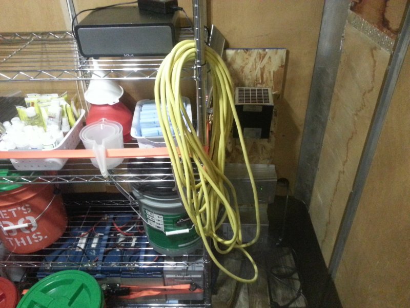

On the right you can see the electric heater 12 volt then below it is the solar charge controller and below it is a 55 amp automatic deck charger. I plug it into 120 and it charges the batteries. The heater pulls 30 amps and the charger can put out 55 so even if the heater were to be running all night on a really cold night, the batteries would still get a charge.
The wands for the pump up sprayers clip nicely on the edge of the shelf. There is a meter that tells me the voltage of the batteries and the state they are in, this also connects to a charge controller for some solar panels. There is a thermostat that goes to the electric heater and a motion sensor for the lights. Also have an electric jack on the front of the trailer.
Please post your thoughts. Let me know if you have any questions or suggestions. Thanks!
Anyone else use those little $15 pump up sprayers from home depot? I bought some 8004 jets from Olsen and they fit nicely as a replacement for the crappy plastic ones that come with these. Puts out probably twice the water now too, so that should speed things up. Used to take forever to prespray with these to get enough juice down. I'll be testing things later today to see how they do.

Travis i think you need some more orange buckets. it's not like you don't have room for some more, right? lol
