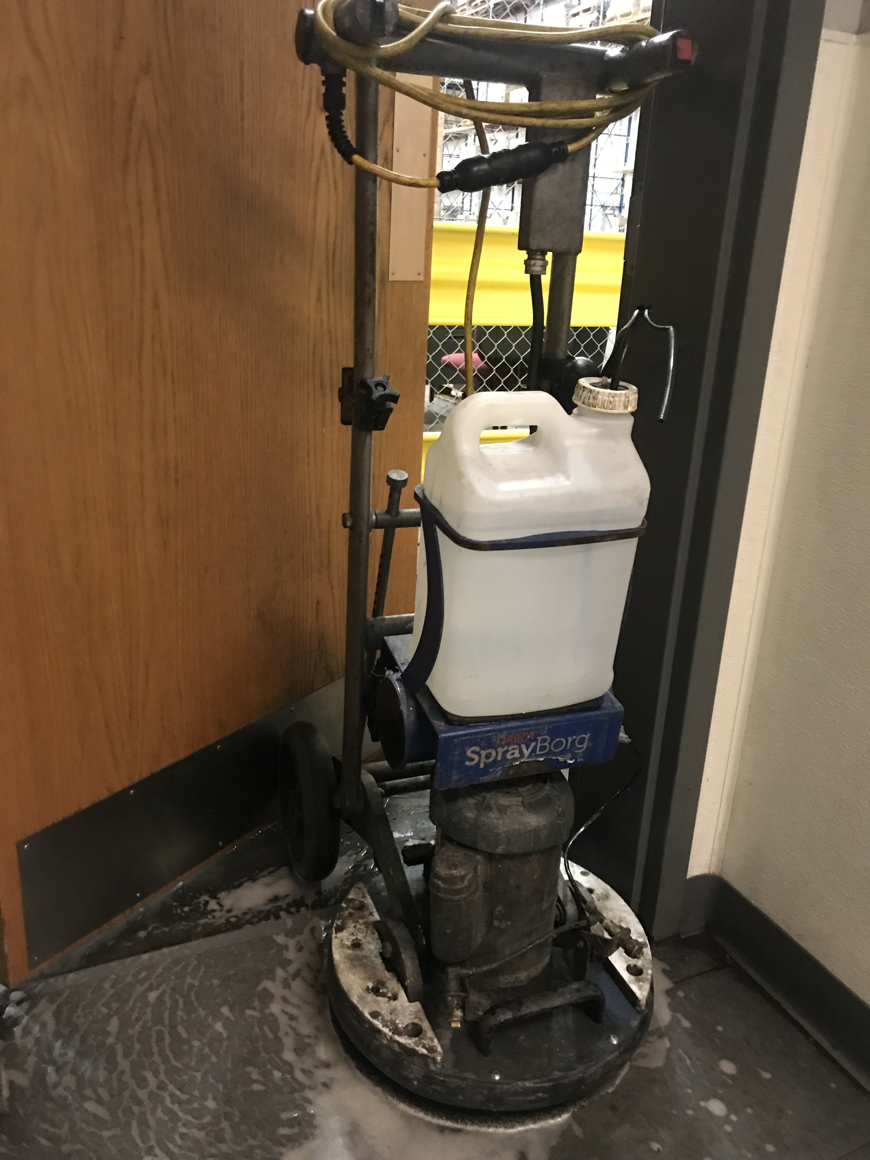

I just finished a HWE on 3500 sqft of trashed glue down. Janitorial Company was there stripping and waxing. They use an Orbot for VCT and carpet. And here it is. These things can take some abuse! 😮

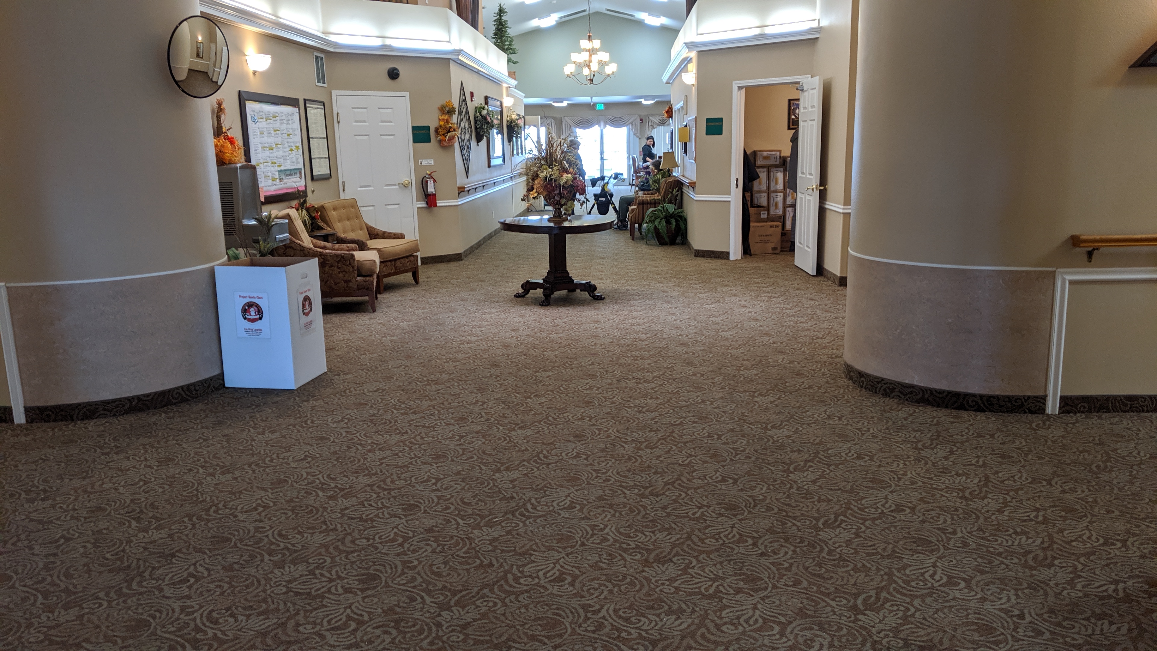

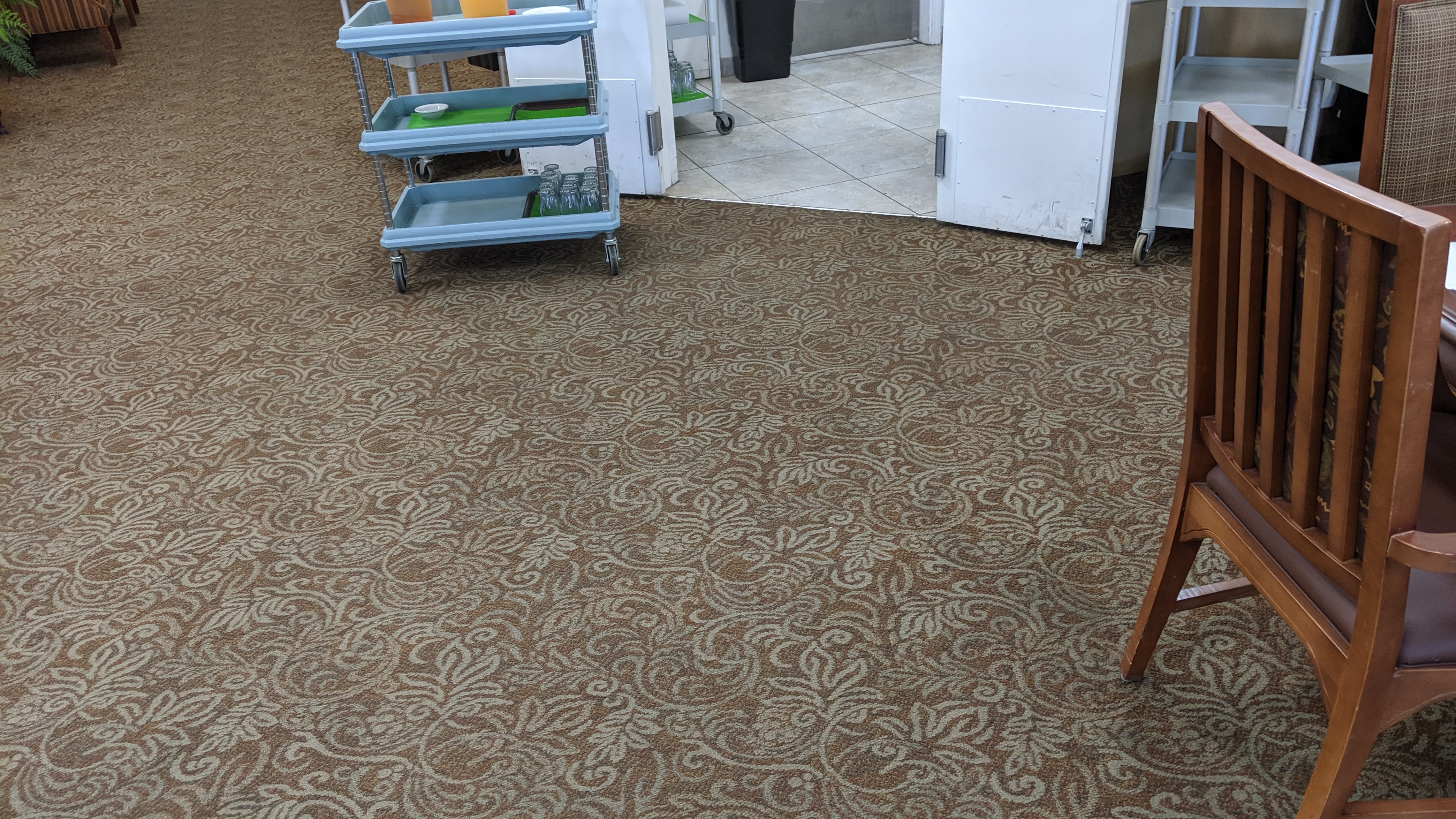

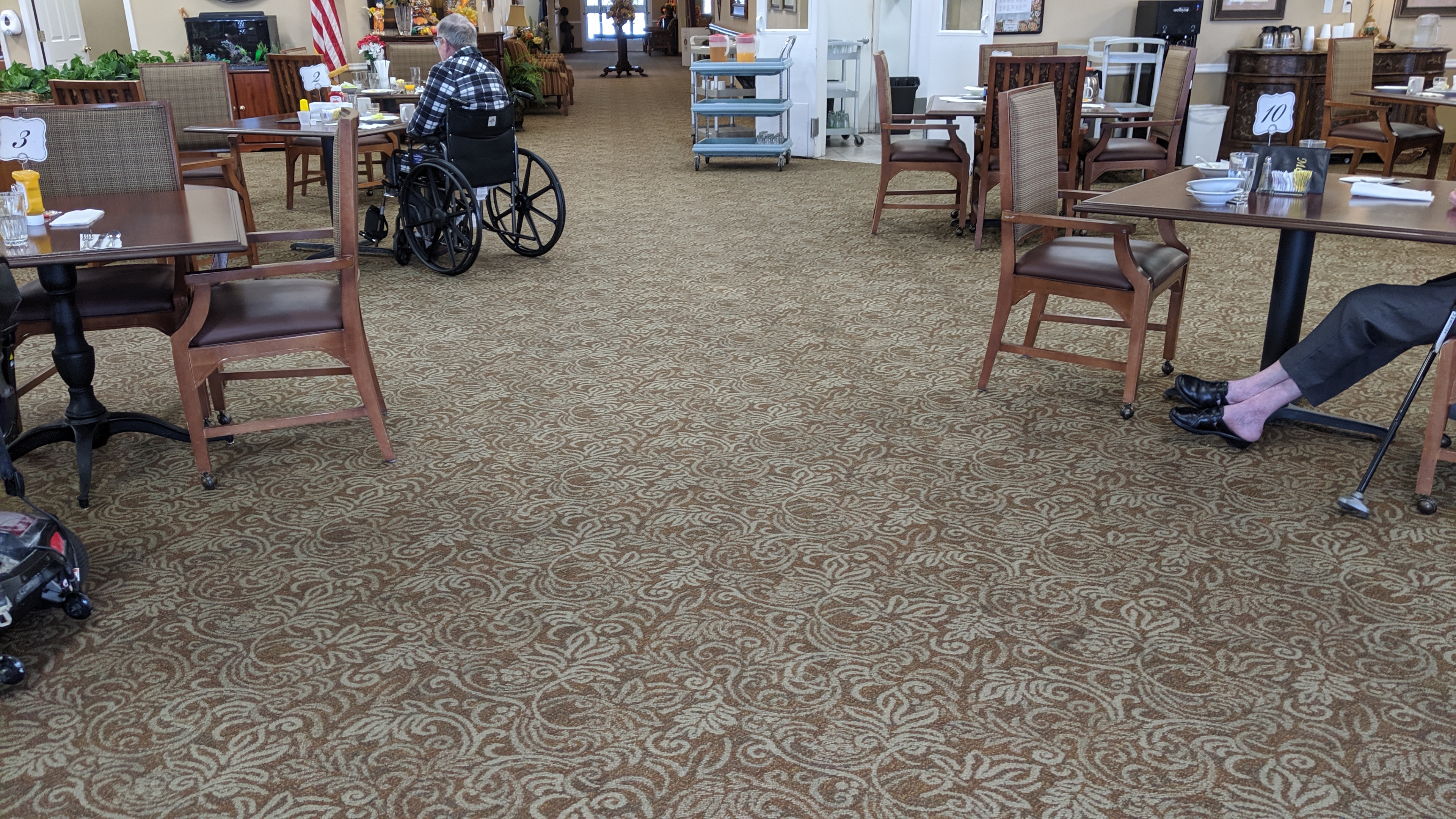

I came back to clean a bunch of furniture today
I and the staff are blown away about how great it still looks.
and no, you can't tell where what chemical was used, it all looks amazing, especially considering they serve 150 meals per day here...MVIMG_20191202_092131.jpgMVIMG_20191202_092140.jpgIMG_20191202_132557.jpg
