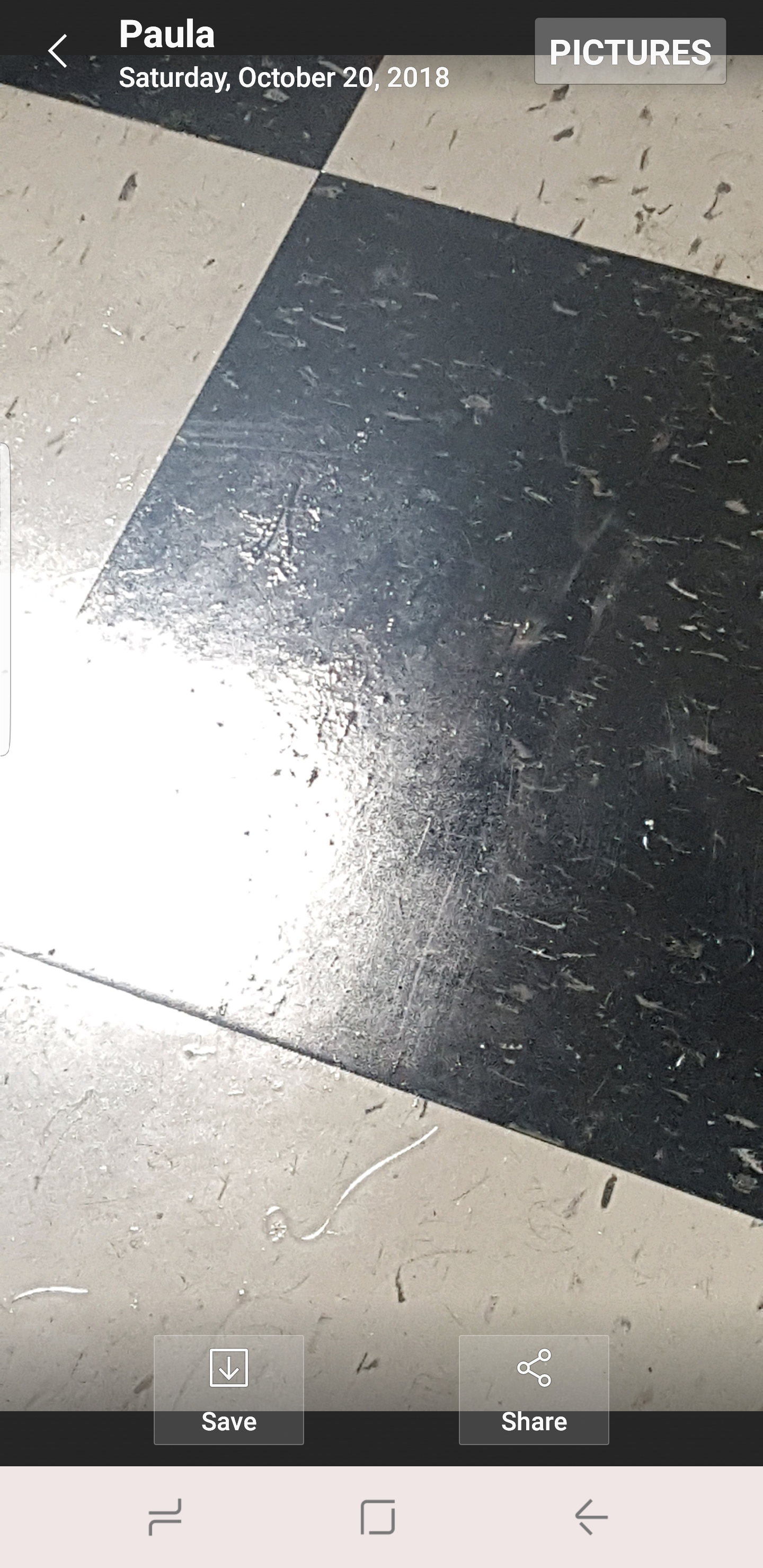

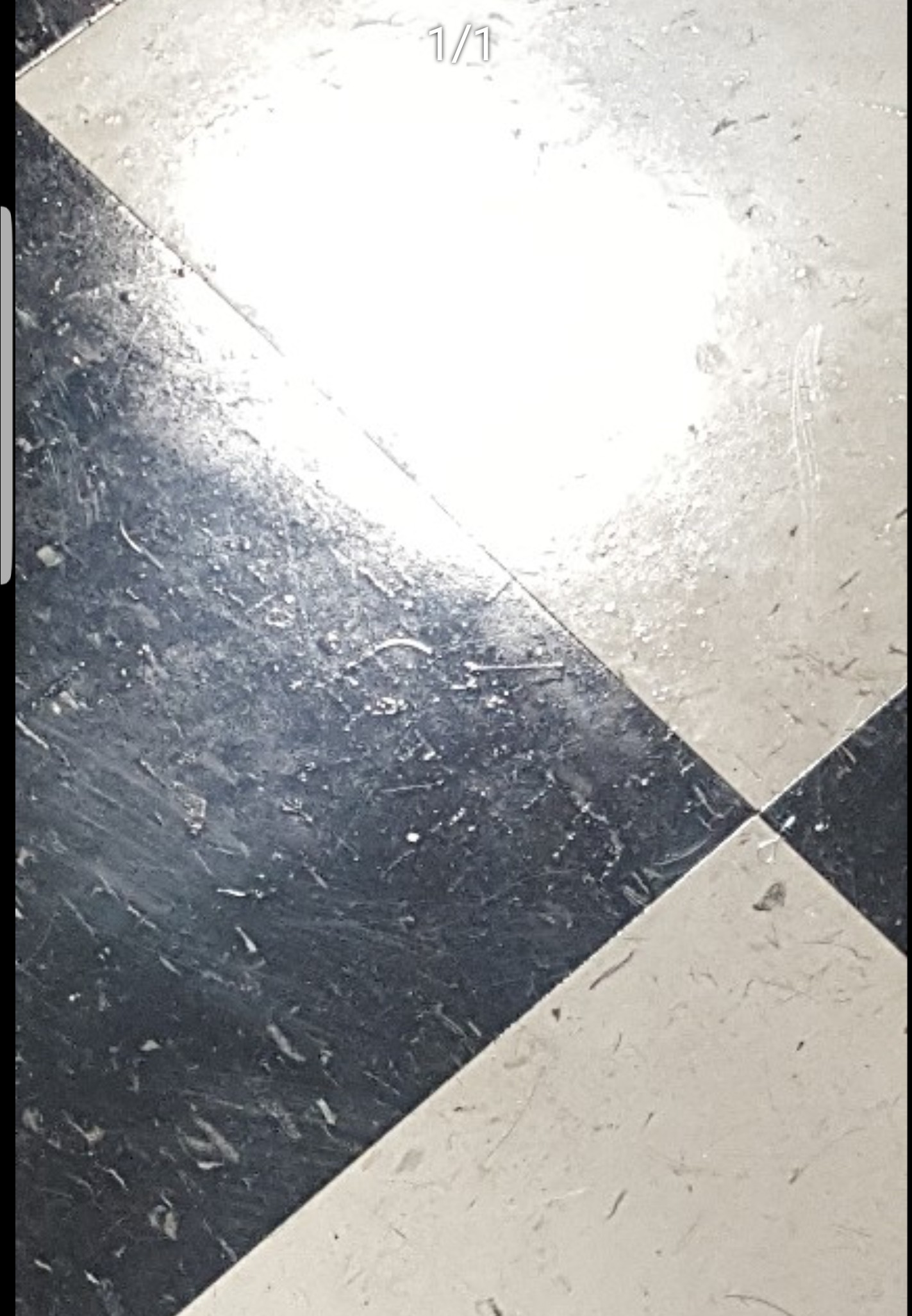

Screenshot_20181020-154916_Samsung Internet.jpgScreenshot_20181020-154925_Messages.jpg
112,732
There is hair under the wax. Strip and wax at 1 buck a foot.
I knkow, this is any area he just did himself last week.
as for stripping, not going to happen, way too much furniture, he's a cheap skate, they are moving out in a year and I just wont do it.
He only want 4000 of the available 12,000 cleaned.
That will cover her tuition balance.

Stick to your plan and get it done. It can't look any worse. Maybe mop on a cheap zep wet look finish when you're done. It will look shiny.
112,732
Those photos are of an area that I wont be touching..
"My" areas have virtually no remaining wax on them, just hair dye stains and mop mud
