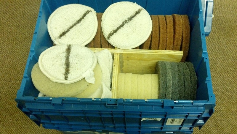

Yea we use all sorts of pads. Tuways with the stiff strip, Fiber Plus, Gray Fiber Plus what ever is needed. Yes if its any size I'd send an Orobt or two for the worse areas.
I was asking more about what you said though....
Yes and no.
You can't see the difference but I personally feel more comfortable anytime its more than average soiling to go to pads for better removal. Light to moderate soiling we encap with the Cimex.
What I was trying to ask with what you said, You use a fiber pad first then a tuway, or a tuway's straight?
Really you can go either way. :eekk:
Let me rephrase that. If you bust it up with the fiber, you can then pick it up with the Tuway.
BUTT the Tuway does a nice job on its own. I'd test for best results. It could be the gray or original Fiber Plus do just fine.

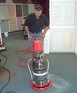

I spent a LOT OF TIME with Chemstractor's back in the day too, before I moved on to the Cimex. I loved the Chemstractor's for commercial work! In fact, when I bought my first Cimex, my plan was to mount a vacuum attachment to the Cimex and produce the world's first planetary Chemstractor style machine. But about that same time I discovered crystallizing encap detergents. It didn't take long to figure out that we could achieve great results on commercial carpet without a need for the vac assembly. Nowadays the Chemstractors are made out of plastic - it's sad to see an end of an era.
