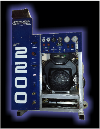

Seems like a powerful dude, but I hate when companies don't put prices on their websites....
Sort of reminds me of an El Diablo.
Cleaning performance of the Legacy 2200 Powermatic would be similar to the El Diablo. But the Powermatic has many features not found with the Masterblend unit.
