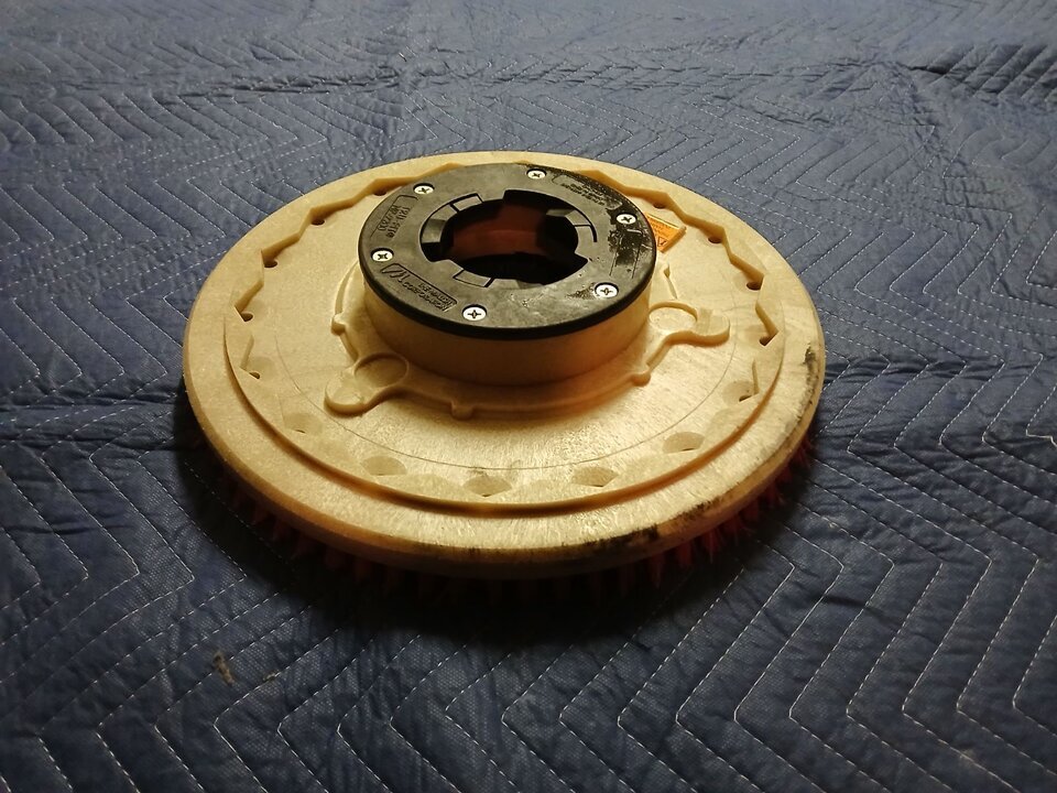

Is it easy to use, I'm 62 and just had my 2nd knee replacement and wanted the easiest machine that will still do a good job? will the driver bristles bend if you let the machines weight sit on them for extended periods? I read your earlier posts (helped me make my decision) that you like "Vacaway Double Trouble" I like Vacaway Encap Green, do you think Double Trouble is better? and i'm going to use mostly microfiber pads cause I don't have a washing machine to keep cotton bonnets clean, are the microfiber or microfiber with scrub strips better with the Odyssey and do fiber pads last or just get chewed up? Sorry, I know that's a lot of Questions,,
Yes Odyssey is very easy to use and easy going up and down stairs
Before you go into customers house make sure you practice on your carpet
It does have some vibration so you need to be careful around walls shelves and tables
Some bonnets grab carpet more than others and can cause more vibration
Make sure you use a good sprayer and put down enough solution to clean and lubricate fibers. Not enough solution can cause bonnet to grab carpet and cause more vibration
I don't like 10'' CRB's because they are too light to scrub with and too slow but for Area Rugs and to groom carpet after cleaning they work perfectly
I used 10'' CRB to scrub and groom and light blue Microfiber Bonnet with Odyssey to extract on that Area Rug
