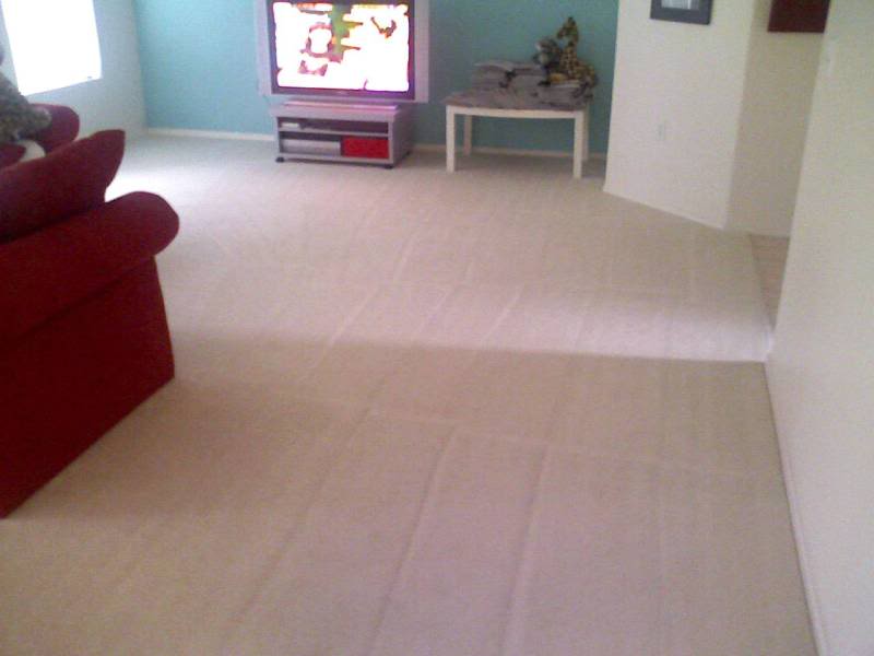

I used to leave bullet shapes, not triangles. When I was first taught, the guy explained that triangular strokes will miss areas. He showed me to use a straight back, straight up with a slip to the side at the top.
I still use this same pattern but I've modified it to slip over on the bottom of the stroke rather than the top, then come back over it with dry passes in reverse. Leaves the carpet pulled all one way with minimal wand marks.
The only time I groom is to work in protectant (ie, there is a functional purpose) or
the wand marks that are left just don't fit the room, ie groom it out for appearance. Did that last Tuesday, 1000sf hotel room, all open, nice plush green carpet, looked much better after it was groomed.
Are you a hack if you don't groom? Nah, the final grooming is probably the least important step you can add.
Protector should be groomed in for the same reason prespray should be groomed in, to make sure you give it full contact with the fibres.
