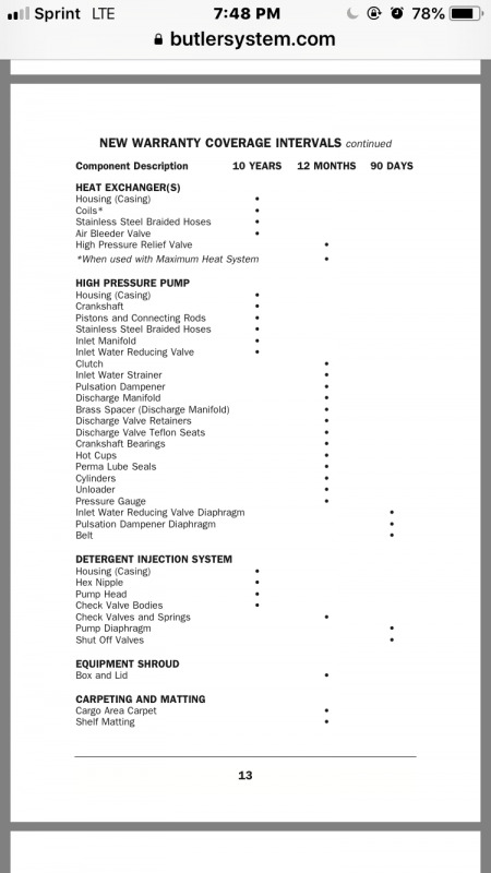

how does a pulse dampener effect PSI?
he could remove the dampener and screw a plug in the hole temporarily to find out if that's it, no??
I'd do that before I let Butler hose me on their price for a dampener
I’m picking up a new unit in 12 days and they only warranty the chem system for 90 days Probably why Hagopian uses a different one on their fleet
