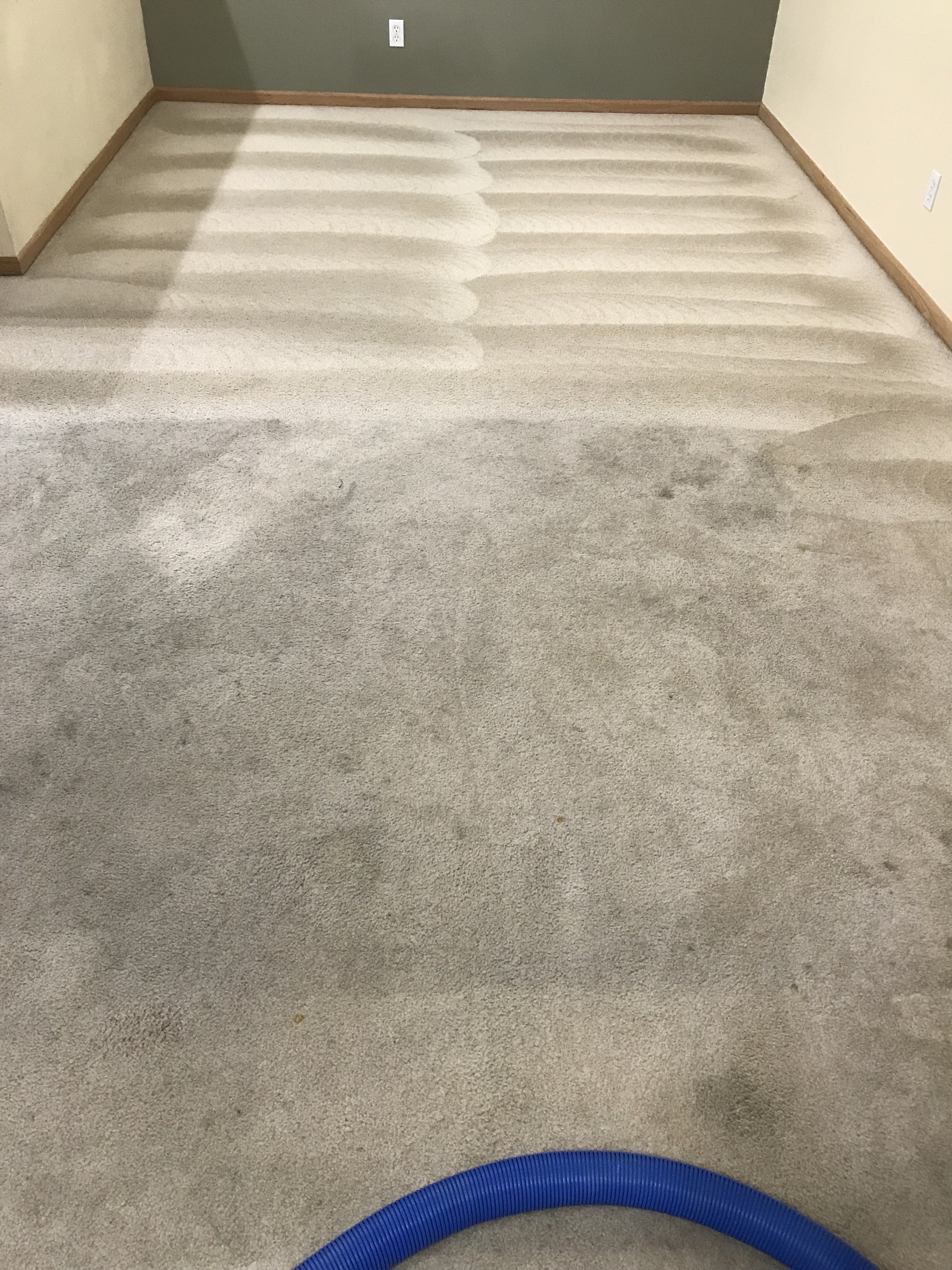

86820
There's no comparison. My Butler is limping right now with a pulse in the line and I can't draw rinse at all. I have a pulsation dampener that will be delivered tomorrow that will hopefully clear it up. Anyway, these results were from a Code Red pretreatment and a fella that knows his way around a rotary extractor. Even delivery of the prespray was kinda all over the place with the line bouncing 100psi. I was without help today, so it was me and my Rotovac. The coolest part of it all is that you can get the very best results and not be tired in the end, like not tired at all. All the work is in setup and tear down.
That carpet was every bit as filthy as it looks in the pic...even worse.
