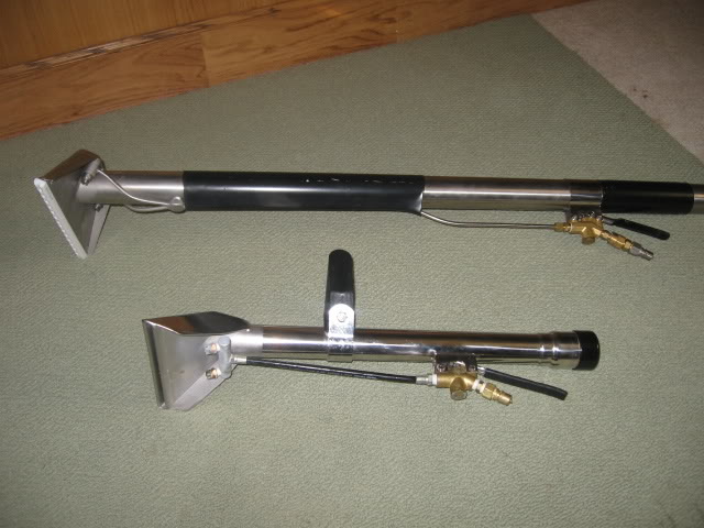

So which is the best available stair tool?
You need to try that long handled stair tool that Olsen sells. Its like a cut down wand. Its a flushing dragon! :winky:
carried a couple different ones on the truck (plus the 4" PMF internal flood jet tool)
Greenie LOOONNG 2" tool
(Cody liked it and grabbed it first.... me not so much)
and the other one that I preferred when wand couldn't be used easily/effectively
for a grip 'n rip thru steps , the mid size tool was better for me (when wand wasn't practical)
But noting is a as dexterous to roll over a bullnose heavily soiled with dog knee traffic than a short hand tool
cleans better, more control ...simply the best ...period
I won't argue with anyone that thinks different
...I'll just snicker and giggle behind their back for being stoopit .....

PMF swivel stair tool for the last 20 years. No need for a glide on a stair tool. Only thing I don't like about it is I had to add a fitting from the hardware store to lengthen the solution hose so it would swivel all the way (everyone I've talked to has done it) . And although it's a 1 1/2 inch tube it narrows down to 1 inch after the swivel. Hence my call out to PMF to make it a 2 inch tube and then it will narrow down to a 1 1/2 tube at the swivel.

Give me a reason to want a swivel for a straight handle stair tool.
I'll give you a reason NOT to want a swivel.
-when you spin the tool around manually without a swivel to clean the risers, you use your biceps and forearm muscles to pull the tool up. A much more natural method that uses stronger muscles to pull it up, which will prevent less fatigue and will be just as fast as a tool with a swivel
Yeah Matt and Ofer you are wrong. If you are going to have a longer handle the stair tool should have a swivel. It' more maneuverable, cause less pain in your shoulders and less wear and tear on the whip hose.
I am speaking from experience as I have all types of stair tool. OMG swivel Seager style gets my thumps up.

I've thought about going back to it because of the two jets and 4 inch width but the prochem stair tool keeps my knees dry.
never used a swivel stair tool, but makes sense the operator can reach square into left or right rear corners without changing body/shoulder/arm position

The swivel enables you to do the tight areas on stairways that curve. It works well around toilets when there is carpet in the bathrooms.
I hear you in tight spaces, but just like Saiger uses his whip to pipe the bull nose
What areas I can’t squeeze with my tool
I pipe with my whip after a a quick blast of steam!
The whip can take some torque flipping it but I grab the wand and whip in one hand to help support the hose!

Stairs are considered detail work requiring a detail tool!

That said I bought the Prochem tool 24 in for $350.00 hated it!
Got a mini Aw29 2 jet I used for year loved it!

I like using whip
With a vinyl cuff for the bull nose
The big plus on a wand is to zip through the steps fast cover more ground.
And try piping the bull nose with a 2 inch cool cuff!
It will pinch the hell out of your hand!
The tools I use now are great on bull noses if angled correctly.

So, there is no right or wrong tool. There is no best tool. You will need several tools to do stairs properly. Use the one that is most comfortable for you and that is appropiate for the job at hand.

PMF Saiger swivel tool with glide. Once you get the hang of it you will love it.
Like I said I swiveled around in Vegas made me feel stupid!
It was way to loose flopping everywhere!
A tighter swivel would be my preference if I had a swivel stair tool!
Didn’t care for the feel of it much!
