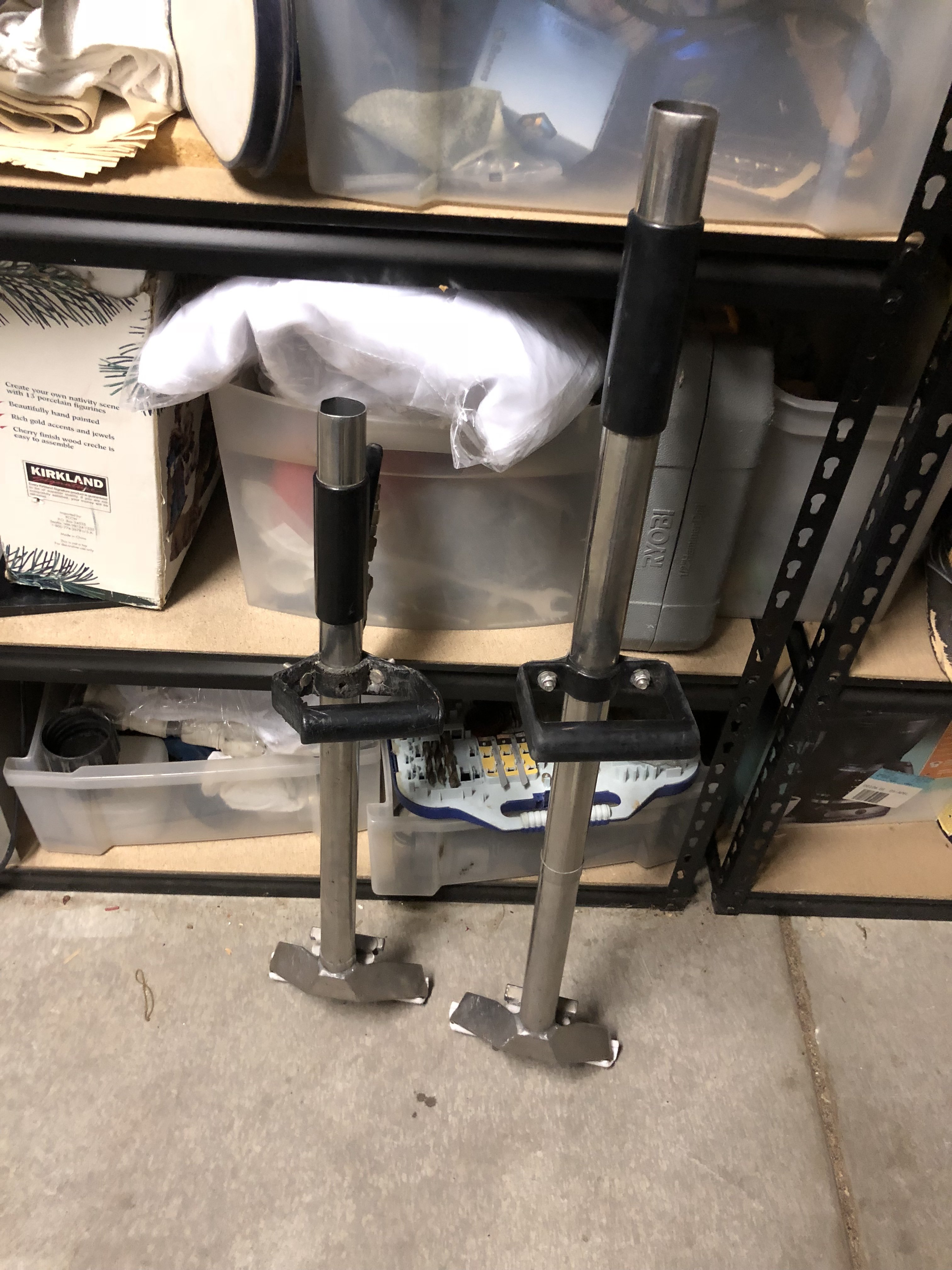

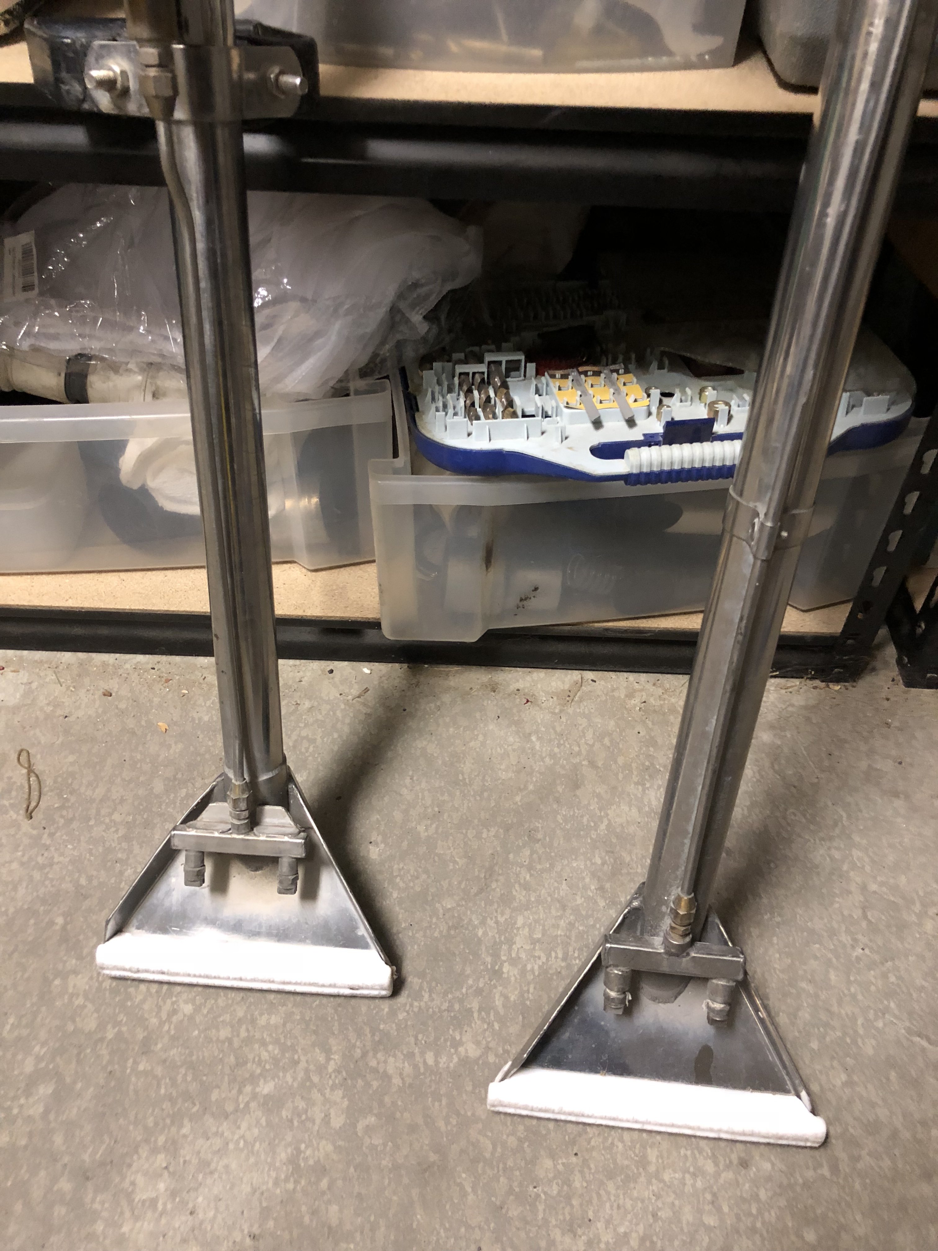

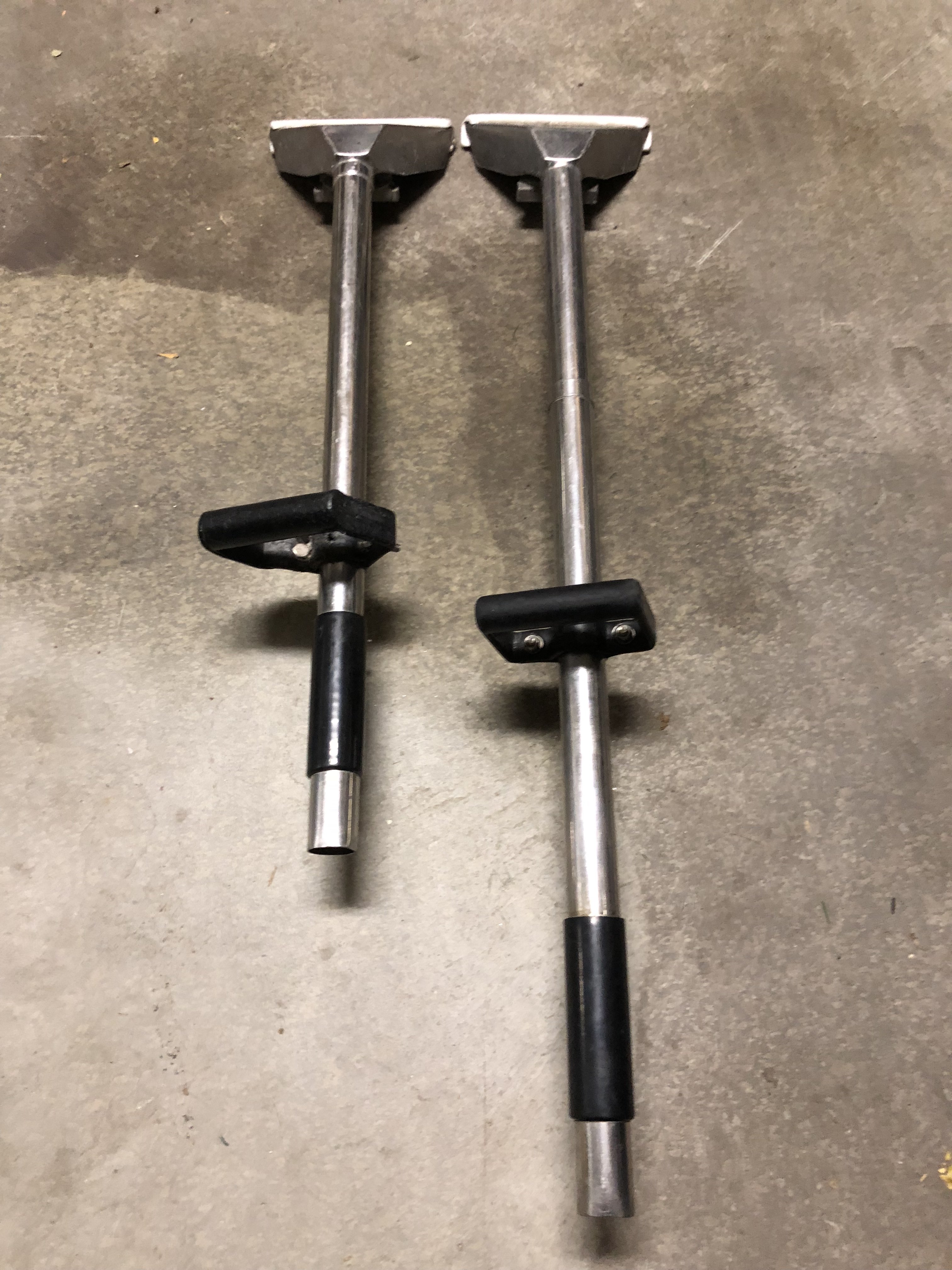

http://www.cobbcarpet.com/zen/index.php?main_page=product_info&cPath=76&products_id=5079
This one I have, Blistor sells one that’s longer they’re both Prochem knock offs!
I like the longer one you can stand up straight and use it!
Connects to a 1 1/2 inch whip!
I just steam the tread and flip it and do the riser!
These tools are good at getting the bull nose to!
But you can still pipe those for more moisture removal!
I wish the Prochem was longer!
But I have had these two for over 4 years and they probably will last forever
