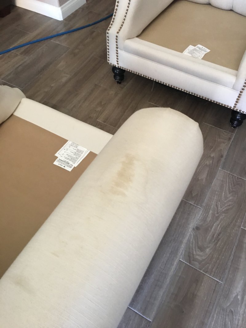

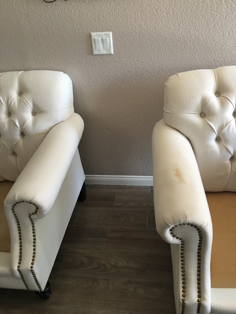

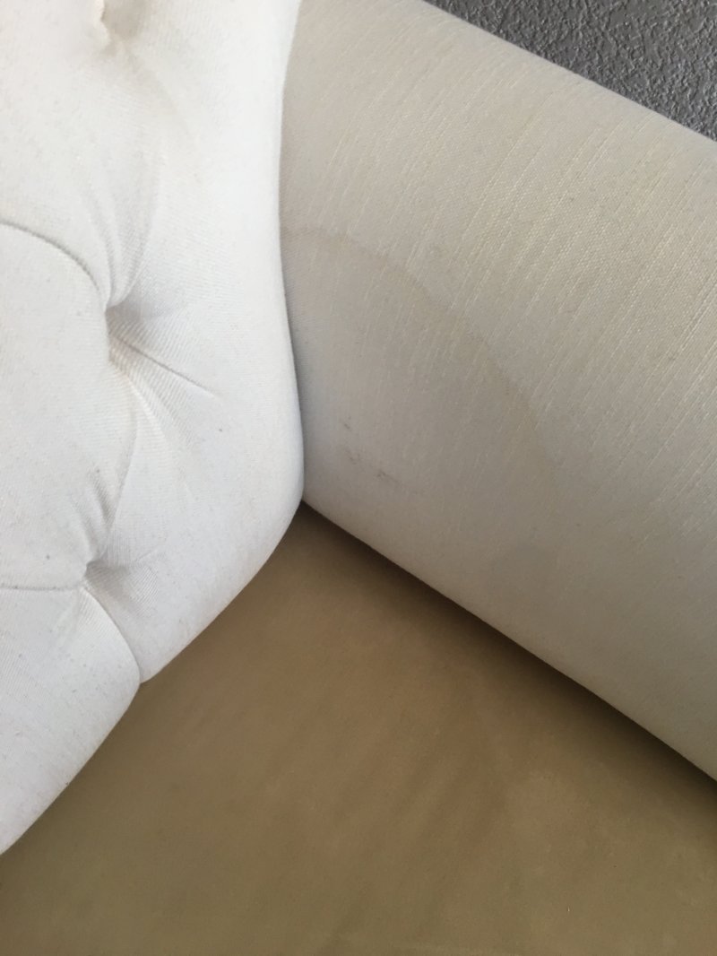

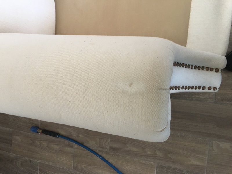

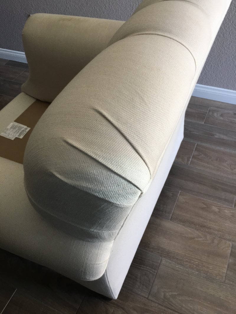

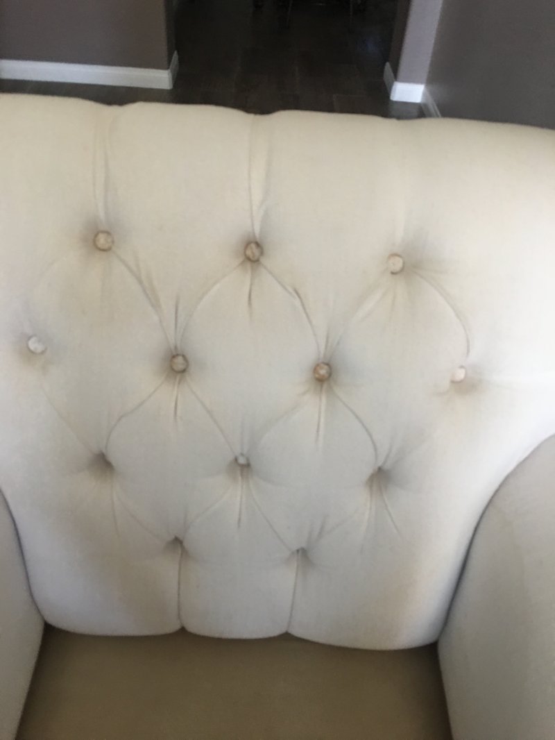

Husband got two free chairs o'boy!
Wife needed a good explaining that her free chairs were damaged goods and not to expect a miracle.
The last picture shows the one on left cleaned one in right pre sprayed awaiting rinse.
Mixed chemspec rust remover 50/50 for the rusty buttons, presprayed with Cobbs upholstery prespray with a splash of brightner. Rinsed with last step and a couple scoops of natural fiber cleaner.
Used upholstery pro tool, looked 90% better with some permanent staining.

Moving and Storage company gives us similar task from time to time.
On those "rusty buttons" beware. It may be hard to keep it from recurring due to deterioration of the metal parts over time.
More...
11,502
Ya I explained to my customer a lot of the rings were do to spotting the fabric, that if you don't wet out the whole area it will do that.
Plus a coffee spill if your to aggressive will leave a brighter ring where the stain was.
I did end up hitting those stains with Cobbs brightner, but I dilute it 50/50 and then extract rinsed. If you were to throw them out side in the sun they would really pop.
But the peroxide could over bleach the stain.
I look at it this way an obvious stain, the coffee, or a faded stain slightly discolored area around it.
Either way she needs to have some covers made for the arms, this fabric shows everything.
