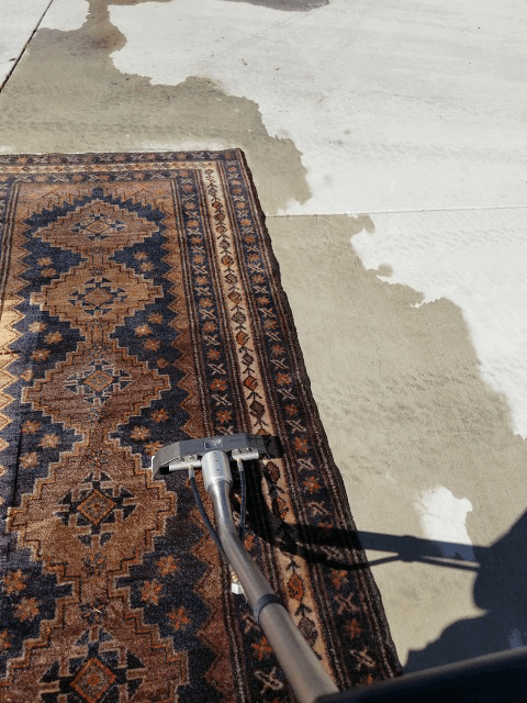

Only reason that It got attention was for the urine.
Dry now and back in service.
