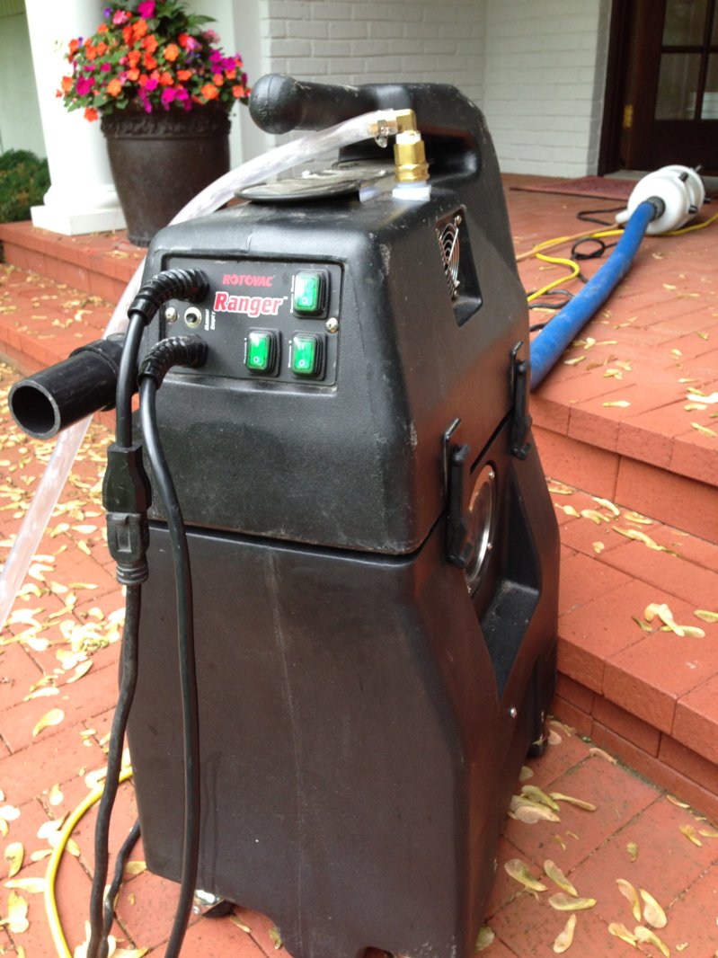

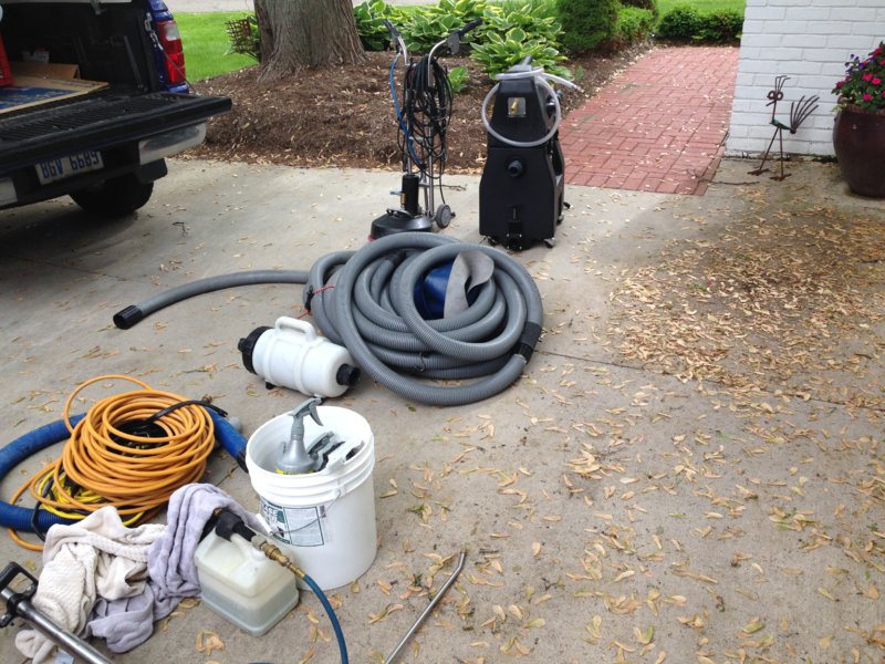

I like to set the CFX outside the front door with a short hose (3-8') always hooked to an external filter like the Mytee one shown:
I will bring 40-90' of 2" hose into the house. I use a 360i for agitation, often using a red or white pad before running the swoop head. The 1 1/2 wand has a 6 flow.
The system is breathtaking in it's simplicity compared to using the TM.

Art, I see you are using a pickup with topper. I assume the CFX in the picture the 15 gallon, not the 15 gallon with the 26 gallon water tank?
So are you a couple jobs a day guy? or are you hammering out 3 to 6 a day?
Your setup does looks simple, I can see why you use it.
Not having the stink of the carpet gear inside the passenger compartment has got to be a joy also.
Thanks for displaying your setup.
Yes, the CFX is just the vacuum machine with a 15 gallon waste reservoir. I only use the Ford Ranger setup if my TM is in the repair shop. It can be a real PIA to do my normal 3-5 job workload with just the porty; I like to use the TM on jobs that benefit from the increased heat and psi and vac that the Pro1200 provides. It's exhausting but it's nice that I have this simple, inexpensive backup system and I don't reschedule jobs.
