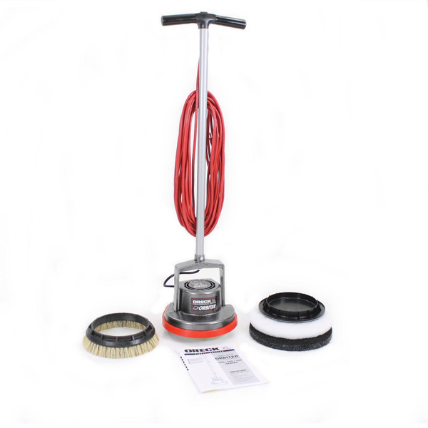

Frank are you talking about the Oreck Orbiter or the Oreck OP the Ricky sells?

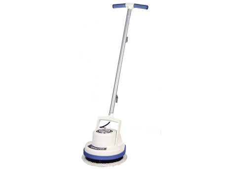

For it's size, weight and versatility, it can't be beat.
A red pad or a MF combo pad under it does wonders, of course on a relatively smaller scale.
Are you really going to lug a big Vario/175 around to quickly bang out a few traffic lanes, or scrub down a few rooms?
After a few months of dragging a stinky porty and it's accessories in and out of peoples homes and tripping over hoses and cords, you'll better appreciate such a effective agitation tool that does not weigh 80+ pounds, that can be carried with one hand, and that does not take up too much space in your mini-van.

I think Frank has specialized in high rise residential. There is very little need for a cimex if you are focused on residential. His van is 4 blocks and 5 stories away. How many trips are you going to make back and forth to the truck? I believe Frank gets everything in one trip. He is going to do 1000 feet of carpet. Would a 175 and pads be quicker than the Oreck Orbiter? Not with two 20 minute round trips to the van for the extra trip to get them and take them back.

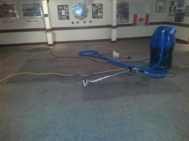

Willy, Am I seeing 3 electrical cords? 1 for heater 1 for each vacuum? I don't see the buckets? Apo, autofeed not hooked up? How much other gear did you haul in for that job?
Honest questions---no sarcasm..
