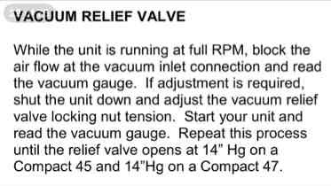

14 inches is acceptable! Some Cleanco basher on another thread posted 12 for the 47 and 10 for the 56.

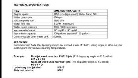

Here you go Marty : Page 6
http://www.cleanco.com/filedir/2f8a01acfbf2727ecae8ddc6de2885de1390835633.pdf
TECHNICAL SPECIFICATIONS
ITEM DIMENSION/CAPACITY
Engine speed 1450 rpm (high speed) Water Pump ON
Water pump rpm 850 rpm
Vacuum pump rpm 2650 rpm
Water flow rate 4 GPM (maximum)
Water pump pressure 1000 PSI (maximum)
Vacuum relief valve 10” Hg/56
Waste tank capacity 100 gallons (optional 120 gallon)
Console weight (with waste tank) 500 lbs.
JET SIZING:
Recommended floor tool tip sizing not exceed a total of “.045”. Using larger jet sizes on your cleaning unit may
reduce cleaning temperatures.
I remember seeing that but I think they're wrong. This is from the manual;

My Cleanco does say that ".045" about the flow. I'll take a small loss of heat to clean with 6 flow. I've been planning on trying 8 flow but haven't bothered with it. It cleans well where it's set. Maybe some people are used to a big slide in and using huge flow and won't be satisfied with any PTO?

Here's my page 6. It's a 2010 Cleanco Compact 47.

Sorry for the bad copy. It does say 14" of lift on the 45 and 47. I'd call Cleanco or TCS to confirm.

your manual matches whats online Russ. It's the 56 that they want you to run 10 on. Personally I think it's capable of 13-14 but it would probably see premature clutch failures especially if you run an upholstery tool for hours.
I think most of these machines are running the same clutches. My experience is that a serpentine drive system is stronger than a dual v belt.

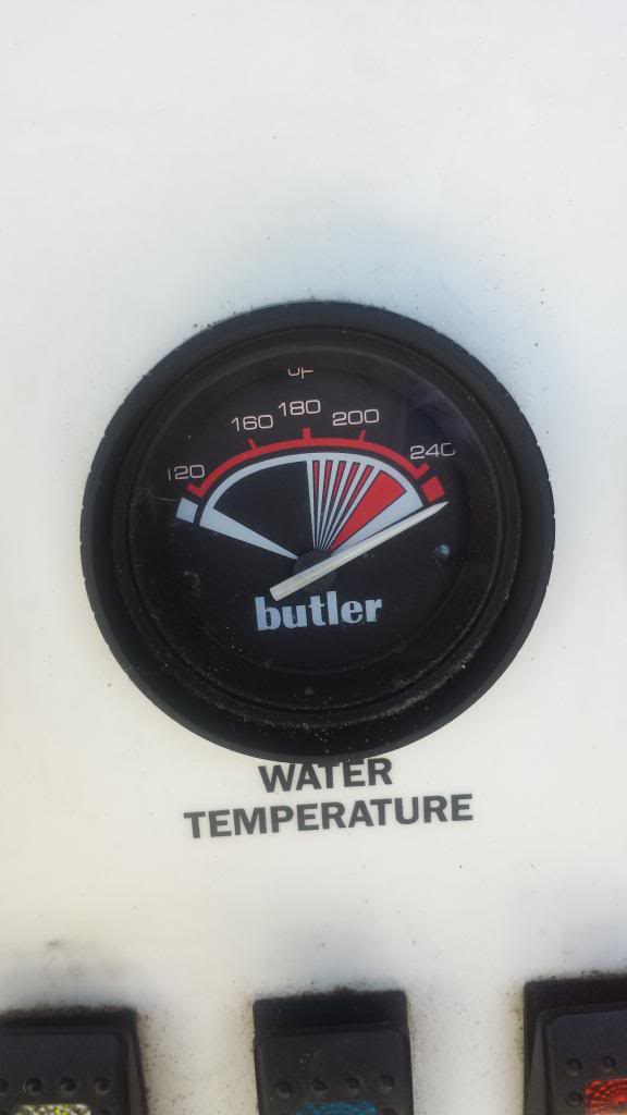

Curiosity is killin me
What is this high heat package fur the Butler? Highest I have seen mine hit was 190 in the peak of summer.
All the automotive guys are tellin me to stick with the lower temp stat to save wear n tear on the engine.
FB7777
" coupled with the Vulcan heating system the Pro 1200 is the hottest in the industry"
Typical marketing bullshit
My Keurig produces hotter temperatures than a Pro 1200

bob vawter
Grassy Knoller
Sep 15, 2007
44,577
bob vawter
Chris.. turn that sucka up hot.....
the only thing is you MAY havta replace the spark plug wires every coupla years ..
what' the big deal....? not even that if ya buy the good ones!
if yous ain't getting QD scars...yous ain't gettin' no heat...

How long, on the first job of the day, does it take to get to that temp? Do you cap off the vacuum to build heat?
