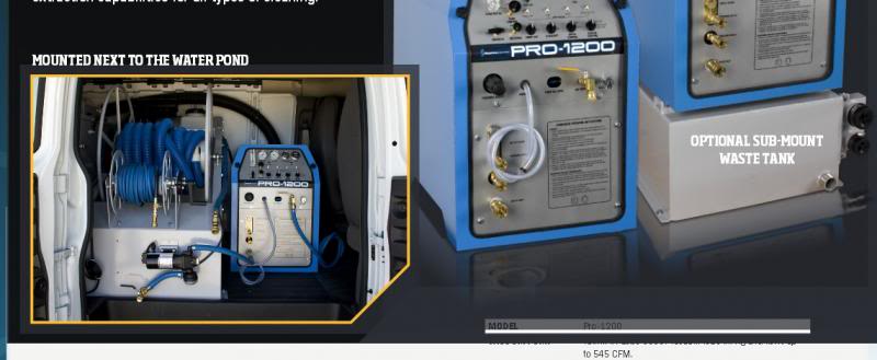

David is yours installed differently than this? Seems like plenty of room to put a jug.

Richard I have the water pond set up like the pic on the left but I wish mine was like the one in the pic. They have the water transfer pump right out in front, NICE!. Mine is crammed between the machine and the sidewall on the left side. I can't wait to try and change the pump when it comes time. That will be a nightmare. Also they have the unit set back and mine is pulled all the way forward because it sits on top of the waste tank. Looks like in that setup a 5 gallon jug would sit in front of it.
