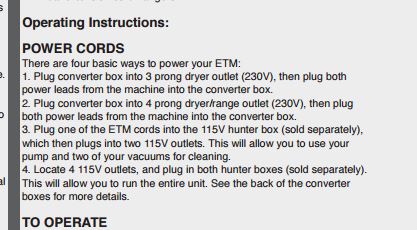

I saw that but didnt believe 2 regular cords could run 4 vac motors with 900psi pump and pump out
The issue is that it is a 230V machine.

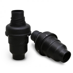

He doesn't have a Mytee--if he bought a duel 3 stage Mytee first we probably would have bought those other portables.
That is a nice feature on the Mytee but attaching a vacuum hose and exhausting the noise 50ft away would provide more noise reduction then those flow restricting "mufflers"
I also have the Mytee 1000DX-200 which has great suction .. 220 psi not bad .. mufflers would be great !!
When I used to clean upholstery with the Kleenrite upholstery machine I'd take a spare hose slip it over the exhaust outlet and pipe the big noise 25 feet away from me. Made a more comfortable work environment. :biggrin:
Haha I was day dreaming running a pipe from exhaust straight up 8 ft to blow the noise up towards the 20-25ft ceilng .. Id be looking like a bumper car buzzing around !!

I was told those mufflers don't work as well as one would like--- go with the 25-50ft exhaust hose instead.
when I totally redesigned my Eclipse I made an Exhust muffer box with egg create foam inside along the walls--
it was designed like a car muffler so as to not restrict flow too much but absorbed the sound waves.

I remember doing the 25' 1"1/2 hose on the exhaust of my dads Electric WorkMaster when I was 8yo... It overheated the unit and we actually had to wait for it to cool down...
I'd be careful messing with the exhaust of a machine... I learned my lesson pretty quick... I also learned to let the gas disperse/vent in a Little Gaint heater too before re-lighting it... Arm hairs and eyebrows singed... lol:hopeless:
the hose might have been too narrow for that blower-- maybe an elbow fitting was place right at the blower?--
As for the "mufflers" larry posted-- I would if they had anything to do with some ETMs catching fire because they caused back flow and over heating?
The key to using an exhaust hose is that It needs to be bigger then the Intake of the motor, which is 1 to 11/2 inch, and no restrictions.-- just like a silencer on a gun
Nate it never had any issue. In fact I got the idea from a Kleenrite class where they had it piped away from us so they could speak while instructing. They also suggested it for use when dry cleaning, exhausting the fumes outside.

I used an exhaust extension many times, often thru a glass pack muffler.
The hose can go into a closet or toilet vent (a kleenrite idea).
