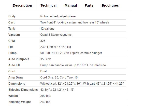

The amount of cords to run this machine is unclear to me. Ive been told 2 but is it 2 30 ampers? .. how many 15 or 20 amp cords will I need to run it? What size 3 stage are vac motors are they?
30 amps total on 2 cords.
One cord @20amps and one @10amps.
It can run on as few as 2 cords-- but you will only be using 2 vacuum motors; and then cant support long hose runs.
Since your main concerns seems to be the noise-- The ETM is the only real option if you want to keep the machines out of the work area.-- however you will want to keep it in a room with no occupants since it is loud! If that is not an option then your goal of less noise in the work area is not obtainable-- so save your money and just move the porty you already have and live with the noise..
Ear Plugs for you and No eye contact with the occupants might be easiest/cheapest remedy. :twisted: :lol:
I wish That were true in reality--- we used 2 hunter boxes with 4 cords total and still blew circuits. We only use the ETM in our rug cleaning plant-We had to hire an electrician to install a 208 single phase 30 Amp outlet with 320 volts!
Maybe the problem was with a defective Pump out pump and it tripped the circuits ? It had to be replaced within very few hours of 1st use.
I saw that but didnt believe 2 regular cords could run 4 vac motors with 900psi pump and pump out
Yeah we wear our ear buds and try not to give eye contact .. I remember one time I turned on the machine and a guy stood up waving his hand in a downward motion .. I wanted to wave back but wasnt there to wrestle. Had another guy ask my helper to turn his machine off cause he couldnt hear .. which he did and I went back over and turned it on. It can be stressful worrying about pissing people off which is why Im looking to modify the process.
I do like the Mytee ETM but its too heavy and the wheel frame is too bulky for me. Id probably like it better if the wheels were up and under the machine but I imagine its probably set up that way for balancing purposes.
