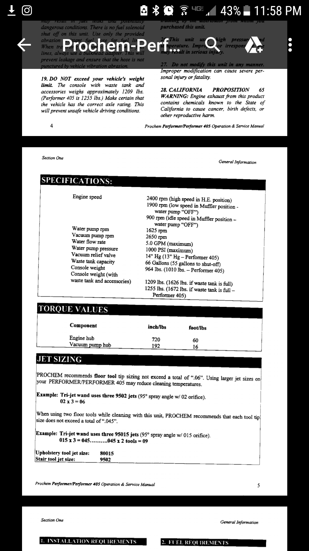

So after doing some more research the manual says the blower is running at 2650rpm but is capable of 3600 also the motor is only running 2400 rpm buy can run at well of 5000 rpm can someone explain what I'm missing here? Lol I attached a pic from manual

Ok and at 80 percent throttle it should be running somewhere between 4000 and 4500 rpm not 2400 wouldn't that allow me to get way more out of my blower especially since it's running at 1000 rpm less than it's capable?

Fair enough. If you are determined to swap out the blower, you might look for a donor 405. The waste tank will need the inlet tube cut out and replaced with the larger inlet. Also the stainless tube that goes through the center on the machine and splits to 2 2” vac inlets will need to be swapped out. And the larger silencer. If you swap in a blower that isn’t a Sutorbilt 4ll you will also have to make a bracket for the air pump. As someone who owns an 870, I have to say one more time....put it back stock the extra vacuum won’t make that much difference. Use all that effort and energy to get more work. Use some 2.5 hose. A bone stock prochem performer will cook and hold 225 230 at 6 flow. You really don’t need to run the engine faster.

Do you think it would be worth changing the pulley on the blower to get it spinning any faster? It's an easy mod just swapping the pulley plus its only running at 2650 rpm its really barely doing 300cfm when its capable of around 400?
J
JS41035
Well, would it be worth changing? Again I fall back on the long term. If you want to swap a pulley to spin the blower s bit faster...sure why not. But if you have a blower with thousands of hours that is working fine...maybe spinning it faster isn’t the best idea. If that shortens the life a few hundred hours would it be worth the gain in cfm? The reason the performers have such a long life is based on excellent components that aren’t run at max settings.
