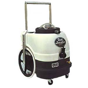

When I have @Cleanworks build me a portable, I'd want some big ass wheels on it like the old Dirt Invader and a dump valve that is slightly higher than a toilet that actually drains out all the sand and shit I see... Maybe even a ball valve for a drain of some type.. Depending on the height of the machine will also depend if I can put my #2lg heater on top of it when I wheel it... Like I said, I have some ideas for my perfect portable...
Who sells the Dirt Invader? Looks like R2D2 in a wheelchair !!

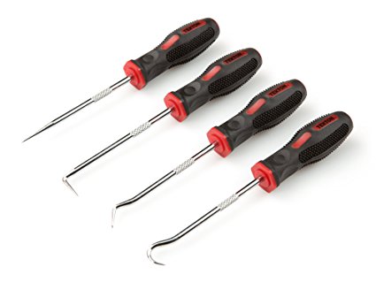

I should get a pick tool for my bag to have on hand for checking and cleaning out the gate seal.
If you tried using your fingers before to clean it out, you would understand why.
Gotta have the right tool for the task, no matter how small it may be.

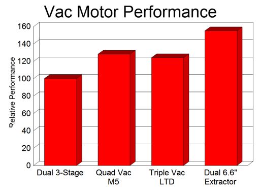

Performance of this Dual 6.6" Vac machine is higher than all of the extractors we have ever tested while extracting the carpet. (11.5" hg)
This included 3 Vac and 4 Vac extractors in the past.
