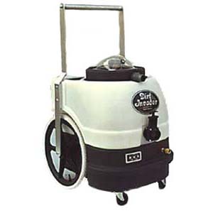

When I have @Cleanworks build me a portable, I'd want some big ass wheels on it like the old Dirt Invader and a dump valve that is slightly higher than a toilet that actually drains out all the sand and shit I see... Maybe even a ball valve for a drain of some type.. Depending on the height of the machine will also depend if I can put my #2lg heater on top of it when I wheel it... Like I said, I have some ideas for my perfect portable...
Unless you loose the gate-valve, you will need a secondary, lower drain like the new LTD'S have.
Gate valves dribble because sand and hard solids get trapped in the thin channel that seals the gate when closed.
Tilting your unit back to empty the last bit of water is a gate-valve killer.
Ball valves are not susceptible to this, so it's probably the best option.
I'm curious how much more a ball-valve sticks out compared to the gate-valve.
I agree on you with tilting the unit back and the sand clogging it.. Either have the ball valve recessed into the unit at an angle so it doesn't stick out or probably use a hose with a cap like the US Priducts Flood King has... Either way, a portable with a tank that has a concave bottom that you can drain everything out of with be the best..
I tend to rinse out my portable on the job after I finish cleaning with my auto fill hose still connected to the sink..
I've also done the turning of the vacs motors on, then opening the gate valve to remove the sand from the thin channel but it makes it get the tank all dirty again..
