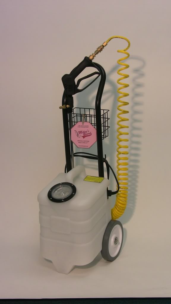

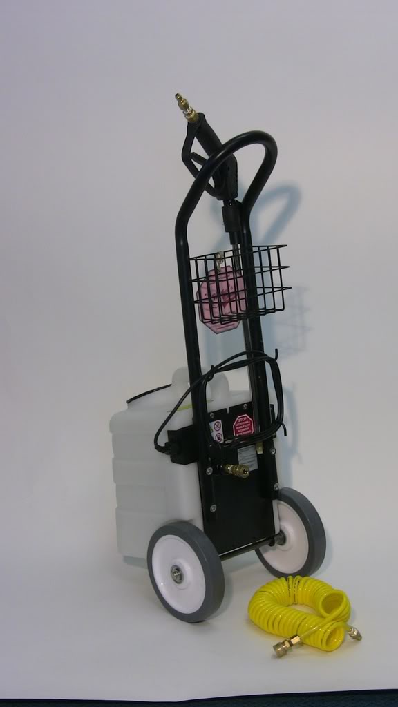

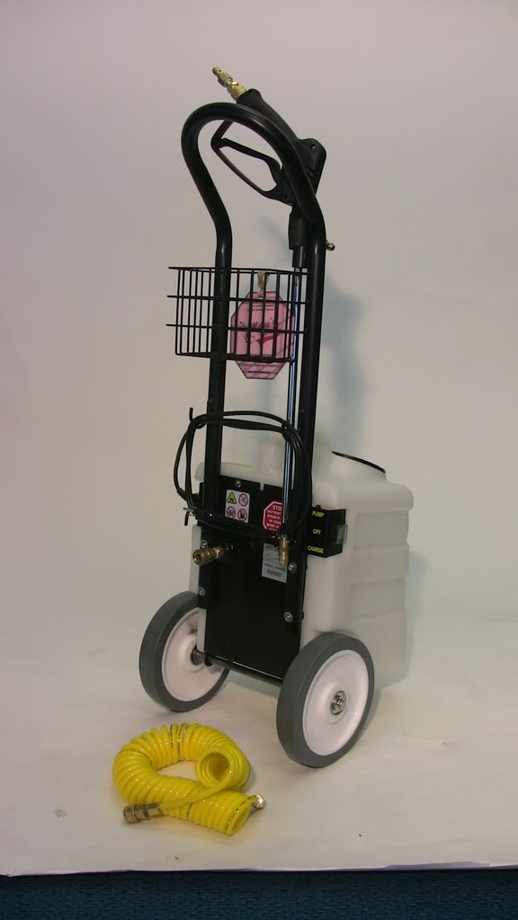

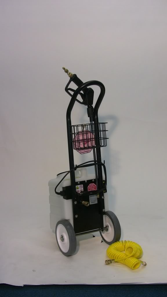

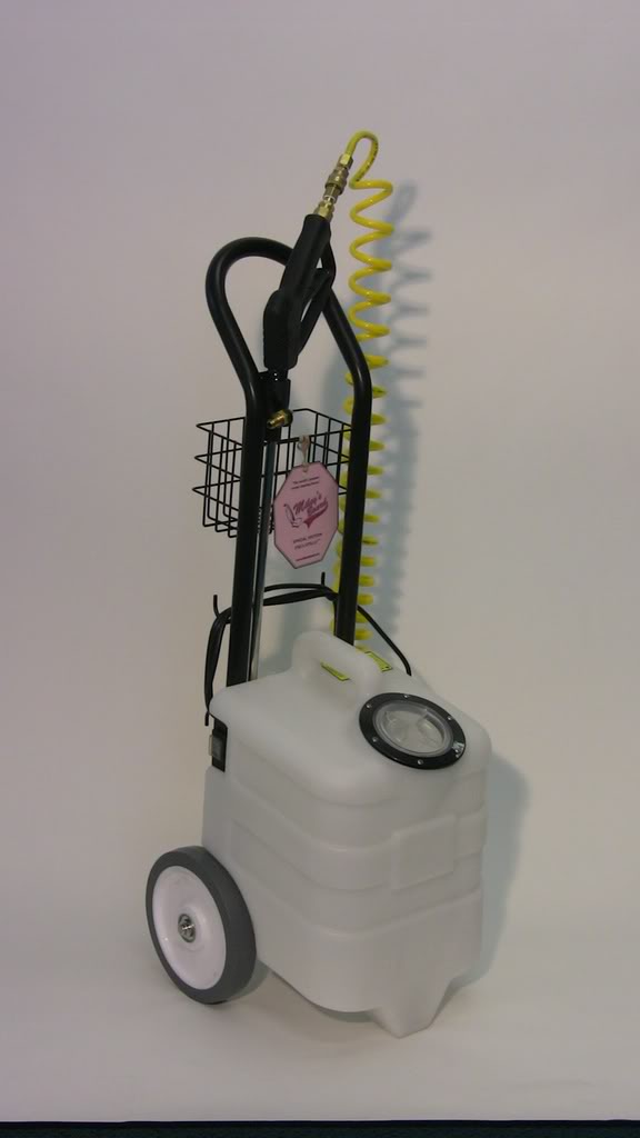

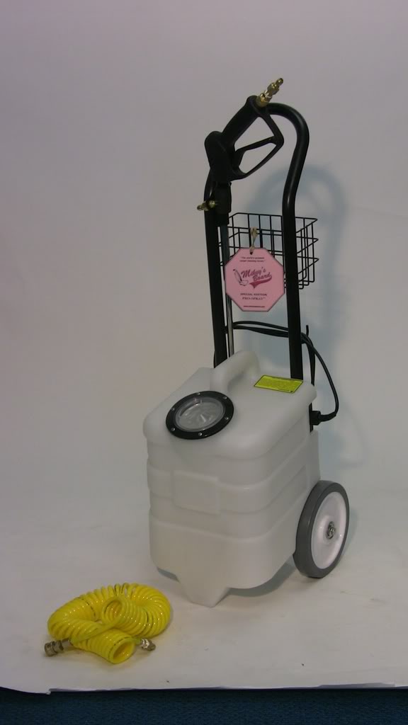

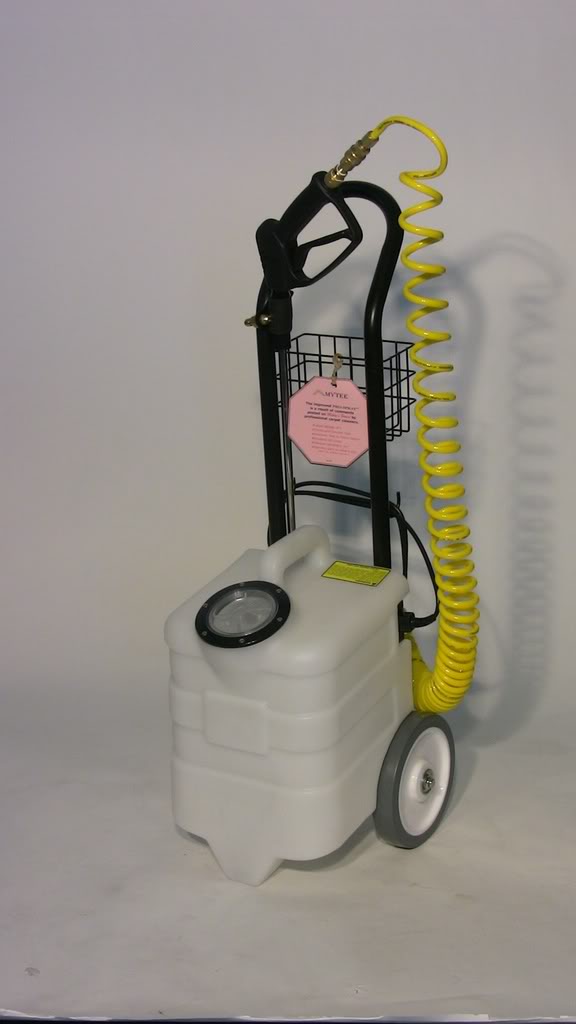

Hi Guys,
Thanks to your comments here is the Mikey's Board Special Edition Mytee Pro-Sprayer. I know you'll have more good ideas so don't hesitate to send them. Order in the month of May and buy for $349.00 Thats a Mikey's Board savings of $50.00. Be sure that your Dist. orders the Mikey's Board Special Edition model 6001.
Thanks Again,
John
Pictures of new and improved sprayer:

Hi Mikey,
I didn't forget. It's Friday and I was using it for a martini when the pictures were taken.
John
